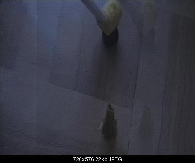

    I don't know what you mean by "color ghosts". Ghosting usually refers to a ghostly echo of something else in the video. Something like this:

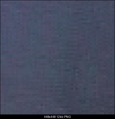

    Not the slight ghosting to the right of the objects. I don't see any of that in the sample. Your video does have some chroma noise. Small purple and green splotches. 8x point enlargment:
    Strong chroma noise reduction filters can reduce that.

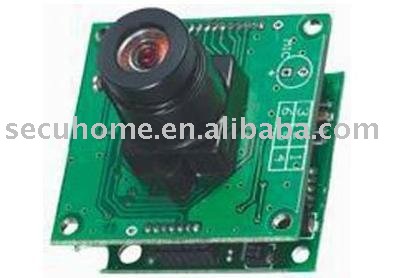

    Google didn't respond to Sony GD-R721E but truncating to Sony GD-R got me this

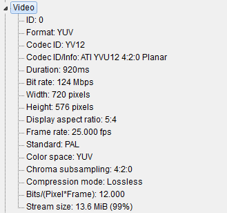

    Your file gave me this in Mediainfo. No where near DV.
    VLC played it in step mode. Looked composite source to me but compressed to webcam level.
