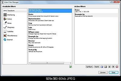

  7. settings:

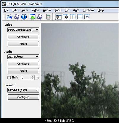

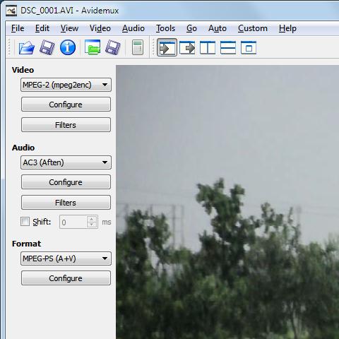

    For MPEG settings I used this, but use whatever you like:

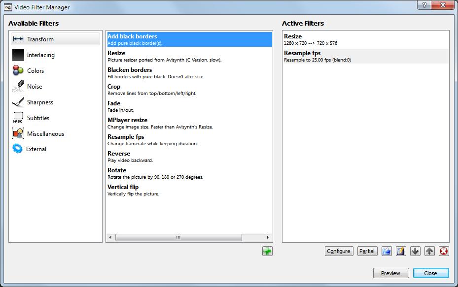

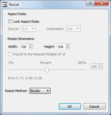

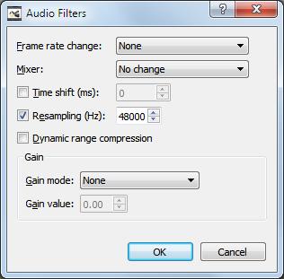

  8. Thank you very much jagabo. It went as smooth as butter. Thank you very much for this nice help.
