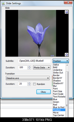

  1. I need to place subtitles where I want. Will GUI do it? Is there a plugin that I can add to it?
  2. I need to place subtitles where I want. Will GUI do it?

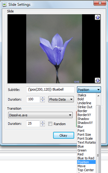

    Yes. Use the style tags. However I've just noticed that the word 'POS' shouldn't be in caps.
    To read up on what can be done with style tags - read up on it here:
    http://docs.aegisub.org/manual/ASS_Tags
