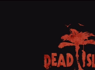

    This is how the entire video is centered. I can send dimension under the image if that was what you meant. Thank you so much man!

    By offset, I'm referring to when you look at that screenshot I sent, Dead Island should be set/centered in the middle of the viewing screen. It appears, referring to a weapon reticle, offset, where the reticle is in the bottom right of the screen, as is the title of the screenshot is, instead of being centered properly. I'm not sure about settings. I've uninstalled & reinstalled Vegas once. Maybe I should try that again? I'll try to reset all to default. Thank you!
