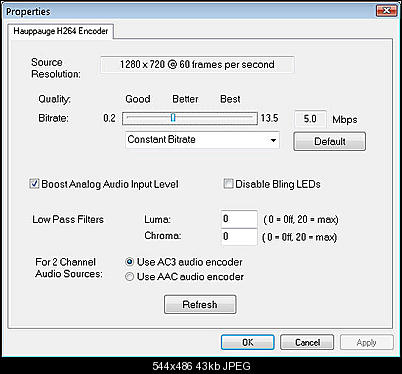

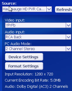

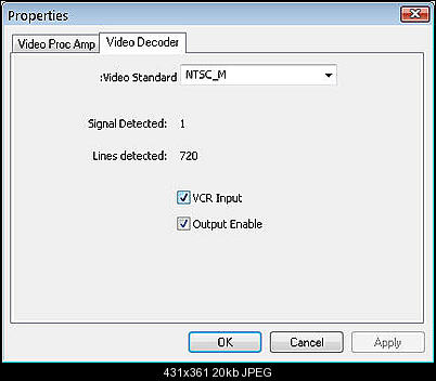

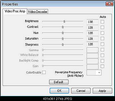

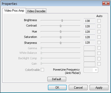

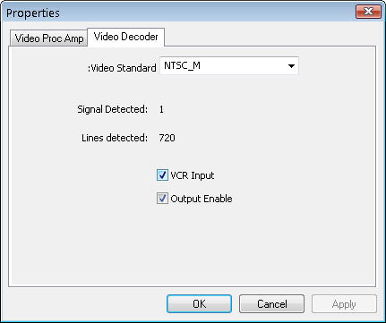

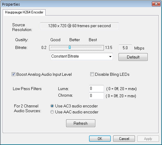

  12. Member budwzr's Avatar
    Apr 2007
    City Of Angels
ID:	8495Name:  snap129.jpg
Size:  25.4 KBName:  snap128.jpg
Size:  16.6 KBClick image for larger version
ID:	8498Click image for larger version
    Here's The Screenshots Of Mine.
    There's no settings in Vegas to post. It doesn't matter.
