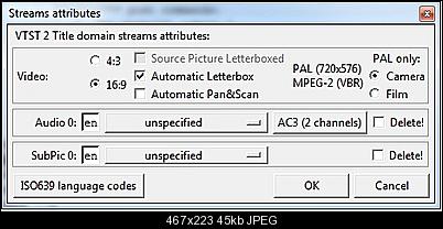

  16. Click image for larger version
    @ manono
    Thanks. Unfortunately as you can see from the screen shot, your theory isn't right. You are right in saying that the DVD plays fine in both stand alone players, and the very same software on my laptop which is playing it wrong once its ripped.
    Changing to 4:3 in DVD Patcher seems to have worked! It plays back right in WMP now, will have to check it on the PS3, but fingers crossed!
    Thanks!!
  17. PGCEdit shows it as being 16:9 but patching the VOBs to 4:3 worked? I sure didn't expect that to happen. But congratulations for going ahead with the patching anyway to solve your problem.
