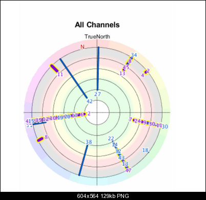

    Post your TVFool plot and we can guide you to the next step.
    If you were central Montreal, your plot would look similar to this.
    This includes analog and digital.

    You could stick a piece of wire in there and get Ch 27 and 42 (V and TQ). Are those the channels you want?
    The rest will take more work.

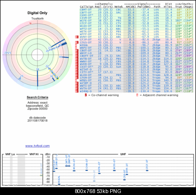

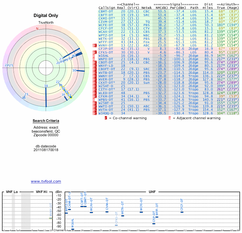

  12. Member Zetti's Avatar
    Dec 2003
    Canada
    Thanks edDV and all that replied, this is my TVfool plot:
    Please, I'm totally a newbie on this, would an INDOOR antenna suit me ? Or do I have to go outdoors anyway ? What would be the drawback of staying indoors ?
    Going outdoors is not "that" big trouble, but an indoor one would definitely suit me better.
    Thanks a lot,
    Zetti

    Anything in the green section of the list is very likely to be available using an indoor antenna. Not having an exterior wall facing in the direction of the station you are trying to receive will sometimes prevent reception, as will obstructions like large trees, hillsides and neighboring buildings.

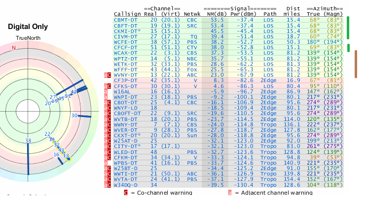

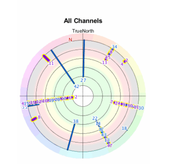

    Allow me to interpret your chart.
    You have 5 local transmitters (marked in green below) located 15 miles away, ~83 compass degees with line of sight (LOS). You should be able to receive these with an omnidirectional indoor antenna. Better would be a directional indoor antenna that you could point to 83 degrees.
    The next group of transmitters are 81 miles distant, 154 degrees in the Plattsburgh NY, Burlington VT area. All of these stations but one transmit from the same location. WCFE (PBS) transmitts from a different location at 194 degrees and is only 50 miles distant. To receive these stations you will need a relatively large directional outdoor antenna and maybe a preamp.
    All of the stations mentioned transmit on the UHF band except one, WVNY (abc) which transmits on channel 13 in the upper VHF band. To receive this channel you would need a combination UHF/VHF antenna.
