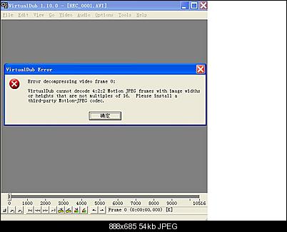

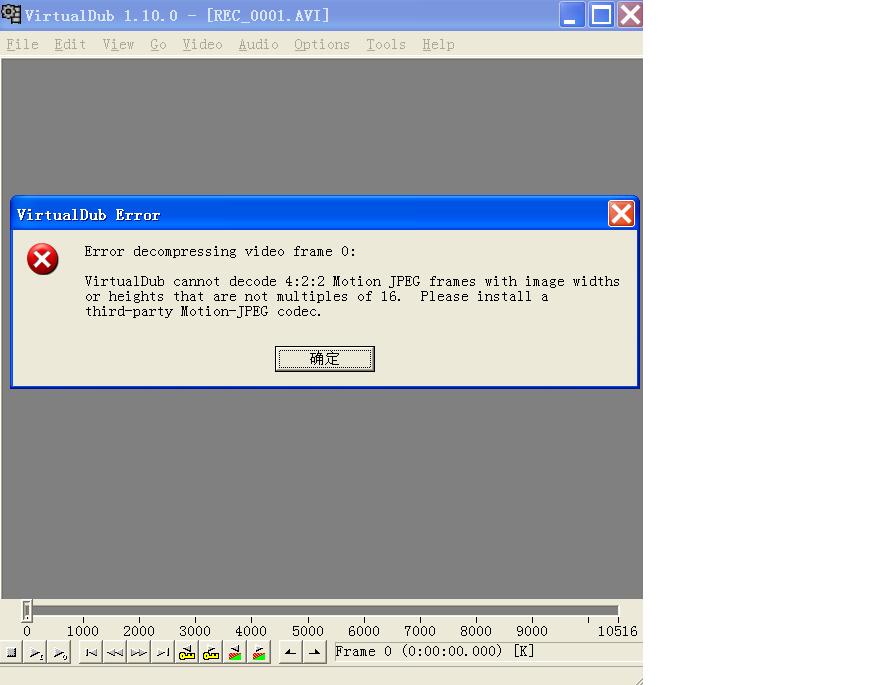

    when i use virtuldub to edit an avi file, the error as follow photo:

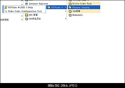

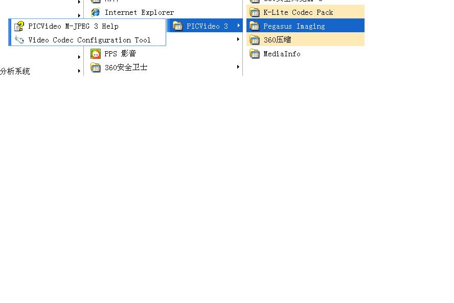

    But i had installed picvideo and k-lite codec pack,

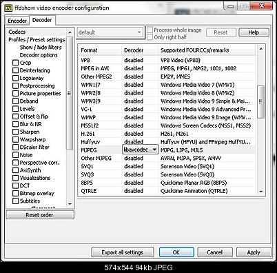

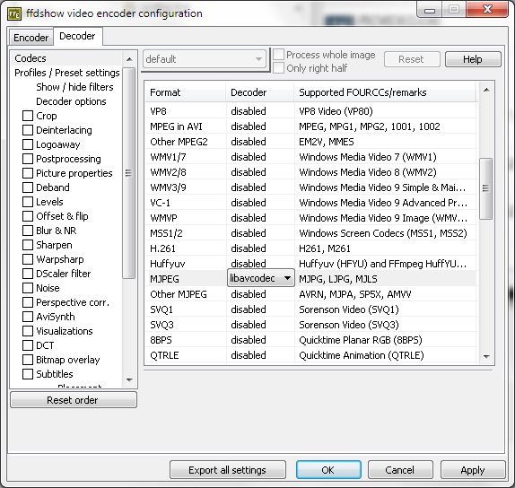

    ffdshow works. Be sure to install the vfw interface. Then run the vfw configuration(from start menu->ffdshow->vfw configuration), under Decoder and codecs enable mjpeg. See image:

    Uninstall k-lite codec pack and try disable the old picvideo mjpeg. You must get ffdshow as the primary mjpeg decoder.

  6. if you use ffdshow make sure you adjust the vfw configuration to support the input (Virtual Dub mainly uses vfw)
  7. If you are using a 64 bit version of VirtualDub you need to use the 64 bit version of ffdshow.
