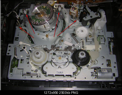

    Anyway, I have an old Sony SLV-940HF VCR/Recorder that had a tape jammed in it. It wouldn't play, eject, or anything. So I had to open it up, and carefully remove the tape manually. When I put everything back together, I noticed it will no longer "take" the tape when I put it in. Usually it sucks it in and does it thing, but it won't do anything now!!
    I've checked the "tape loading bracket" and mechanically it works fine. I put the tape in and can manually slide it back and down. But for some reason, the VCR it won't automatically feed. Also, the VCR itself seems to work fine. Everything is spinning and moving, etc.
    Here are some pics. I'd really appreciate some help

    looks dead to me. the tape loading mechanism is in the play/record position, not the empty/loading position.

    I did notice that, but depending on what buttons I press and whether or not the power is on, they do go into the empty/load position.

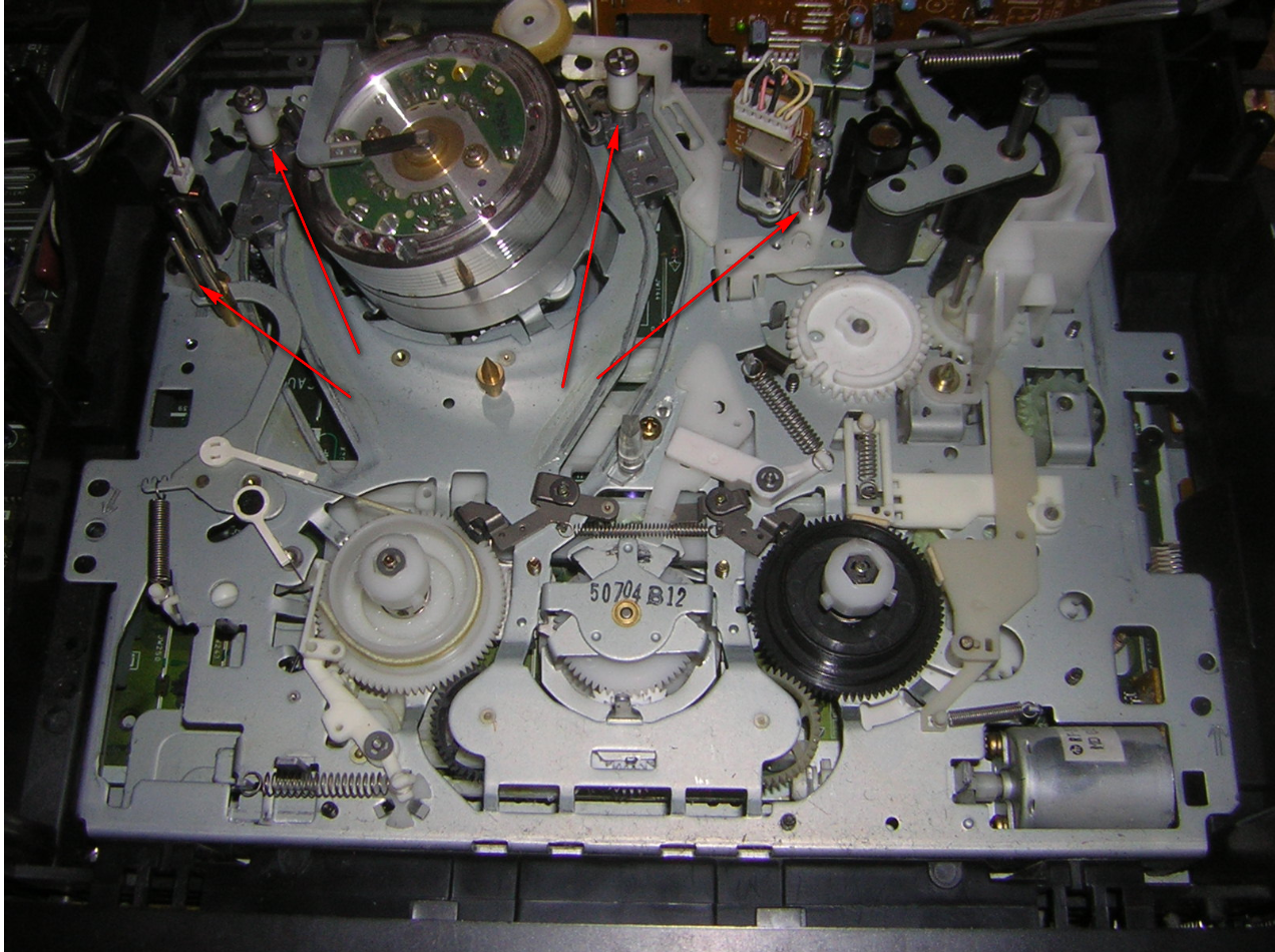

    Here are a few pics and a short video showing what happens when I press the play button without a tape. It seems like all the mechanical parts are moving fine now, but don't know for sure.

    Looks to me like the loading mechanism is not working. There is a motor and possibly a belt or belts involved that control this function. Your original post said the tape was stuck inside. Un-loading or ejecting is the opposite of loading.
    From www.fixya.com, here's an answer given:
    "Dear Rob, There can be two reasons for your problem.Let us consider the simpler and most likely cause.....Belts!!!
    Unplug the Plug from the Power socket. Open up the top and bottom Panels.Check the belts. Most likely you will find a belt has snapped ( a 80% possibility) or become very very loose. Also check the Tape Loading mechanism,there is a small belt which connects from the Loading motor to the Loading Mechanism.
    Replace the belts as a entire set."
    You'd have to check around the Internet for parts, sometimes EBay, www.parts.com or www.mcmelectronics.com stocks replacement belt kits. If it's a worn or broken gear or gears, then it becomes more difficult.
    Sony recorders of this vintage usually make a loud whirring noise when loading or ejecting a tape. If you don't hear it,
    possibly the loading motor is shorted or not working.
    Seems to be it would be more practical to bring the unit to a qualified VCR repair technician and get an estimate to fix it.
    The repair charge might be more than what you'd pay for a new or used VCR, but that's your choice.
