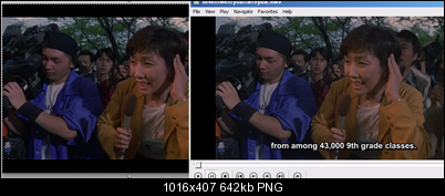

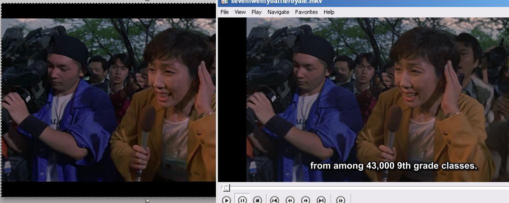

    I want to adjust the saturation and brightness of my .mpg to match that of the .mkv.
    The screen cap on the left is the video I've been adjusting to match the one on the right:
    Is there a program that can tell me exactly what adjustments I need to make the images match?

  2. I think you just need to use the proper color matrix to decode the videos. The HD video is rec.709, the SD video rec.601. In AviSynth you can use the ColorMatrix() filter to convert one to the other:
    ColorMatrix("Rec.709->Rec.601") #make the HD video match the SD video
    ColorMatrix("Rec.601->Rec.709") #make the SD video match HD video
    Or you might try the ColorLike() filter in AviSynth.
    http://forum.doom9.org/showthread.php?t=96308
    You probably can't make the adjustments with RGB filters.

  3. Isn't there a mistake there, jagabo, as both colorimetry conversions are the same?
    thrakk, if using AviSynth (as you should) and the ColorMatrix filter, and downscaling from Hi-Def to Standard-Def, you should use:
    ColorMatrix("Rec.709->Rec.601")#I'd also use clamp=0 in there.
    Read the doc. It should fix the problems you're seeing.
