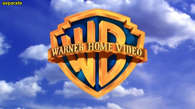

    Here's some examples of a 720x480 interlaced MPEG 2 video (DVD rip):
    SeparateFields()
    BicubicResize(640,180)
    Weave()
    Subtitle("separate")

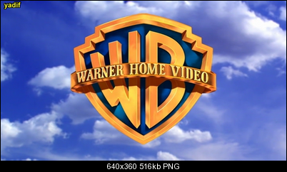

    Yadif(mode=1, order=1)
    BicubicResize(640, 360)
    SeparateFields()
    SelectEvery(4,0,3)
    Weave()
    Subtitle("yadif")
    Note the bright thin highlights at the top of the logo.

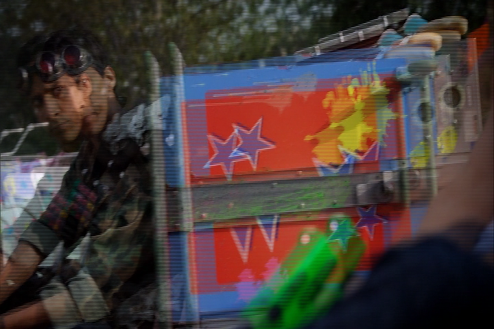

    Those are pretty subtle. Here are some very obvious examples.

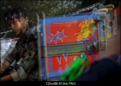

    Original interlaced frame:

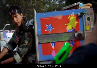

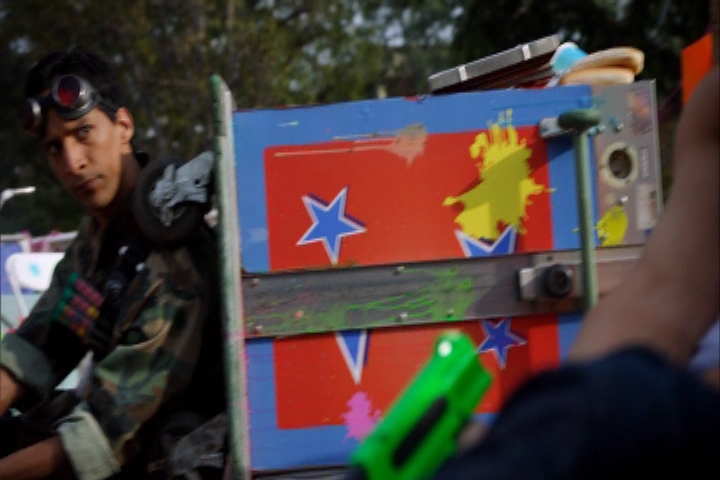

    Correctly bob deinterlaced into two frames:

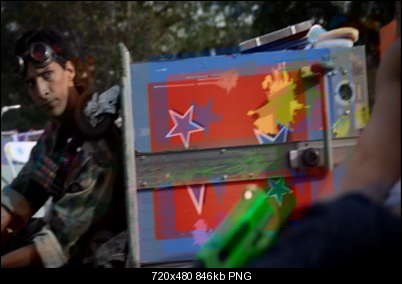

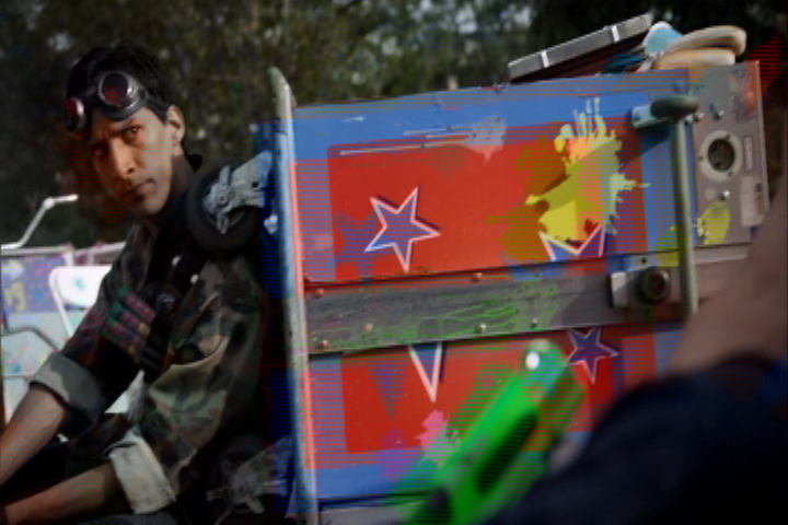

    Incorrectly bob deinterlaced into two frames by VirtualDub (interlaced YV12 problem):

  18. Yes, bob is a crude deinterlacing method (though it's very similar to what you get with an interlaced CRT). But it's the simplest method of cleanly separating two fields and keeping a full height picture. That is, I didn't want to use a complex filter, or sequence of filters, where you could speculate that the problems were caused by the filters, not the incorrect interlaced YV12 to RGB conversion by VirtualDub.
