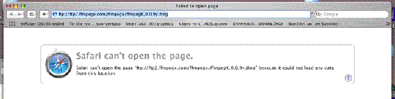

    It used to do it for me as well, but not any more...
    Any suggestions will be more than welcomed.
    Thanx

    Perhaps your FTP mode isn't set to 'passive' (PASV).
    Or perhaps you have selected to use an FTP proxy server that isn't working properly.
    Or perhaps a firewall on your Mac or a setting in your router is blocking the data port that the FTP server tries to negotiate. It should be automatic, if nothing prevents it from doing so.
    Or try a different browser or a dedicated FTP client.

    Thanks a lot,
    it worked ok when I turned the FTP mode to passive as you said.
    I downloaded fine, installed it ok ....
