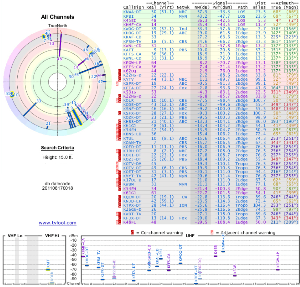

    http://www.tvfool.com/?option=com_wrapper&Itemid=29
    Is a good sight to plot your location re transmitters and help with antenna design. Post the plot here (less address) to get an antenna analysis.

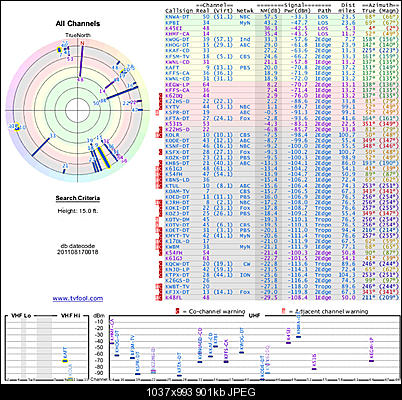

  10. Member dragonkeeper's Avatar
    Jul 2003

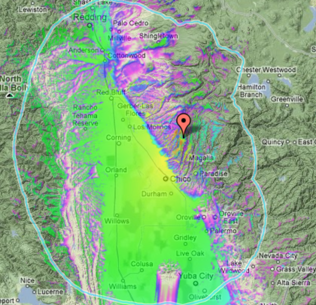

    Here's the plot.
    Murphy's law taught me everything I know.

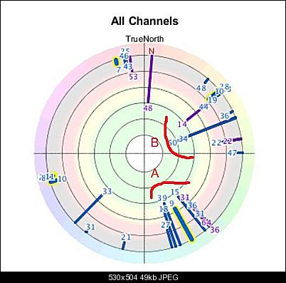

  12. Member edDV's Avatar
    Mar 2004
    Northern California, USA

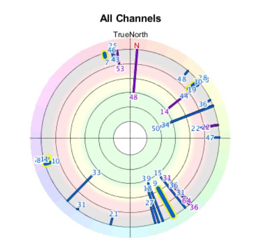

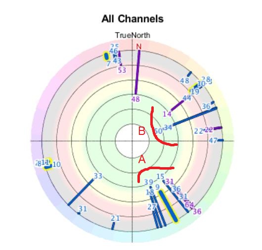

    You will need two fixed antennas or one with rotator. You are lucky that only one strong channel is VHF (ch9). That will take a separate antenna design. Attic mount usually cuts reception in half vs outside pole.
    Direction A will be easiest (other than ch9). The stations are grouped and the signals are stronger. Direction B has two strong stations. The rest look weak. The list view will help me predict which will come in.
    A good plan is to ask/observe what neighbors are using.
    For direction A, I'd suggest these antennas. Shop online prices.
    93" Deep
    http://www.solidsignal.com/pview.asp?mc=03&p=91XG&d=Antennas-Direct-91XG-UHF-TV-Antenna-(91XG)&c=TV Antennas&sku=853748001910
    50" Deep (you may need a pre-amp* to make this one work)
    http://www.solidsignal.com/pview.asp?mc=03&p=43XG&d=Antennas-Direct-43XG-UHF-TV-Antenna-(43XG)&c=TV%20Antennas&sku=&more=yes
    http://www.solidsignal.com/pview.asp?mc=03&p=4228-HD&d=Channel-Master-4228HD-8bay-HDTVUHF-TV-Antenna-(4228HD)&c=TV Antennas&sku=
    This antenna has a built in amp and rotor. It may work outside.
    http://www.sears.com/shc/s/p_10153_12605_SPM3173222802P?sid=IDx20101019x00001a&ci_src=...=SPM3173222802
    * I use this pre-amp
    http://www.summitsource.com/product_info.php?ref=1&products_id=7067

  14. Member dragonkeeper's Avatar
    Jul 2003
    Yeah I was thinking of building an array consisting of at least two antenna one pointing northeast and one pointing southeast. I live in a two story house so i was hoping the added elevation would partially make up for the fact that the unit is in my attic. Also I have the added benefit having direct access to my attic through a door in my upstairs hallway, so set up and adjustment should be a snap.
    Here is the Plot and list view data.
    Everyone i know is either on satellite or cable, they are totally unaware that they can get the local channels for free and in most cases better quality than they current provider is able to offer.

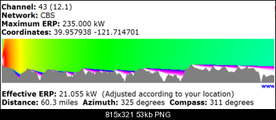

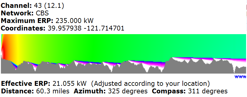

  16. Member edDV's Avatar
    Mar 2004
    Bad news is you have only 4 LOS (line of sight) choices. All the othere have one or more hills/ridges in the way (1Edge/2Edge) not counting trees or buildings.
    Good news is you are fairly close to Fayetteville
    http://www.kiva.org/about
  17. Member dragonkeeper's Avatar
    Jul 2003
    Yah, I'm in a mountainous region. I knew that anything past Fayetteville would probably not have LOS, since they are further down the mountain range. But it does provide optimal conditions for trying a fractal antenna.
    Mountains and ridges here too. 1Edge and 2Edge paths are tricky. You are grabbing spill signal that bends over hills and ridges. TV Fool has a nice feature few know about. If you click on the call letters, TV Fool will plot a signal path to your location showing the terrain between you and the selected transmitter. This is the path of my best network station. This station usually comes in but others come and go seasonally and by time of day. Antenna pointing needs to be +/- 2 degrees or it goes away.

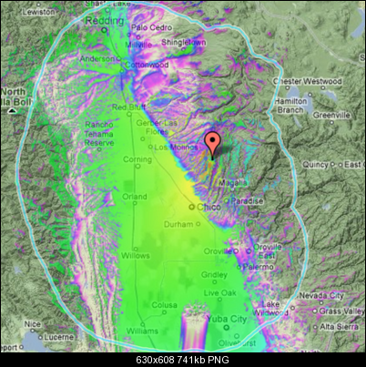

    There is an additional tool useful to predict reception.
    http://www.tvfool.com/index.php?option=com_content&task=view&id=66&Itemid=1
    Same station as above. The marker is the transmitting antenna.

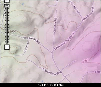

    You can zoom these maps down to the street level to predict neighborhood reception for that paticular transmitter. Pink means a very weak signal requiring a large directional antenna.
