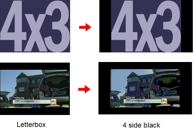

    Originally Posted by carlos28355 View Post
    i know its not the player in the case because even just viewing my desktop i got the same black all the way around..
    If you get black on all sides on the computer monitor with the player set to full screen then it is a player settings issue.
    Top and bottom letterbox is normal for movies that are wider than 16:9.
    A 16:9 TV series should not show letterbox on a 16:9 screen.
    Black side bars result when 4:3 is played inside a 16:9 frame.
    Four side black results when 4:3 letterbox is played inside a 16:9 frame.
    example:

    ok @usually_quiet ill give that a try thanks and @edDV not to be rude but i do know its not a player issue. this isnt letter box issues its the fact that the picture will NOT go to the edge of the screen playing a movie or not..the desktop wont reach the edge browsing the internet wont reach the edge
