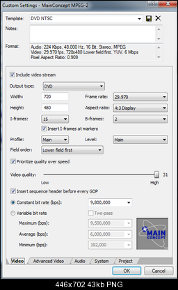

    dvd standard mpeg-2 is a file not a dvd. it would be in the render as section if the options are available, not in properties. it would look something like this in custom.

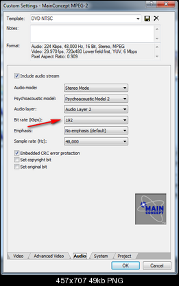

    the audio bitrate would be adjustable in the audio tab. chroma 4:2:0 is normal dvd mpeg-2 as in the template. it would render as an mpeg-2 file(video + audio) you could upload or submit.
    you can change it to upper field first, my mistake in the picture.

    Thanks for the reply! I cannot seem to get custom settings on render. I pull up render as. I do see Mpeg 2. I click on that and then it asks for a template and gives a list.
    There is no custom that I can see. I emailed Vegas but have yet to hear from them. I have Vegas 11 which I assume is the most modern of the consumer editing systems so its odd that it wouldn't have that. Or is it there but I can't see it , meaning I have to actually search for it somehwhere. ??

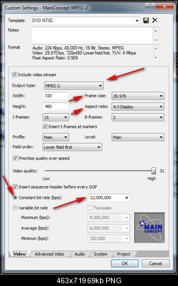

  9. aedipuss - You have to change the output type from "DVD" to "MPEG" to allow 12Mbps; otherwise the bitrate will be capped at 9.8Mbps as per DVD specs

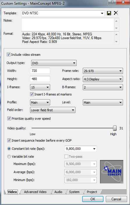

    I downloaded a trail version of Vegas Pro 10. It does allow me to customize the rendering but I cannot seem to find Chroma and Video bit. They require a video bit of 12 Mbps.

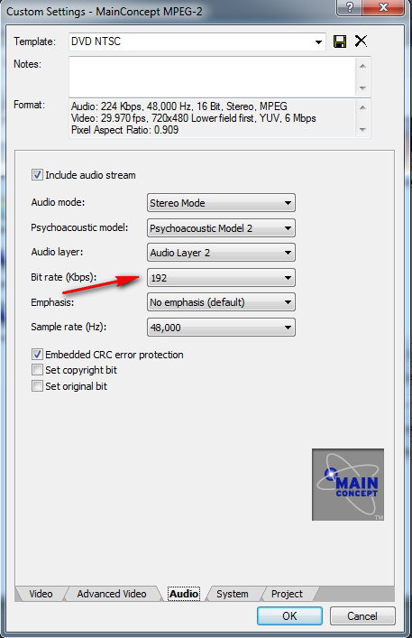

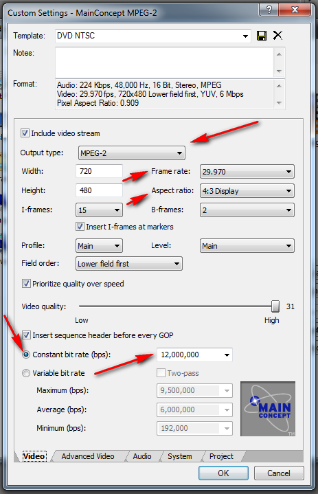

    by definition dvd spec mpeg-2 is 4:2:0, you can't set or change that. bitrate is set in the custom panel. looks like you'd need to switch the field order also to upper field first.

    Thanks Aedipuss! So I am slowly getting it I think . I had to manually change the video bit to 12 as it wasn't part of the choice. So simple yet so hard for me!
