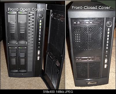

    What's your 10TB system setup ?
  10. aBigMeanie aedipuss's Avatar
    Oct 2005
    666th portal
    2 - plextor px-nas4's. each with 4 - 2TB hard drives in raid5.
