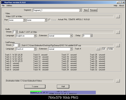

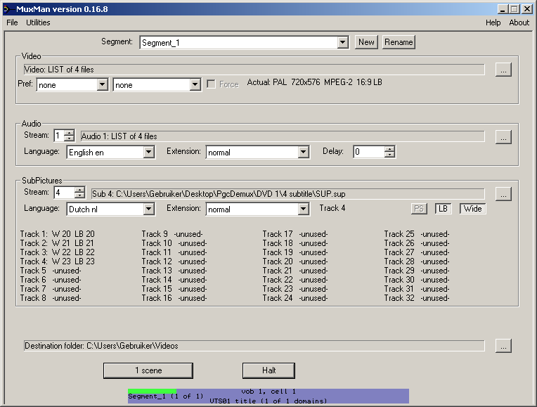

    See picture below: I put the subtitles on different streams/tracks... Not sure that's the way to go tho
    Edit: Just found out what it does... And it puts the subtitles on several tracks, which isn't what I want ofcoz.
    I just want 1 subtitle for 1 episode...
    Edit 2: Still having weird colors, altho I changed the colors with Subtitle Creator. I just used DVDSubEdit and made some changes to the color-scheme, using the guide u mentioned. Will let u know if it's solves the color-issue...

    It depends on whether or not there's only one title in the VTS, meaning everything is all joined together and all four episodes should be treated as a giant single episode. Or if there are four different titles in that VTS. In that case you do as before, extract each episode separately to its own folder. PGCDemux, PGCEdit, VobBlanker, DVDDecrypter, or other programs can tell you if there's one title or four in that VTS.
    I used PgcDemux and it turns out, there are 3 titles in this VTS, each round 'bout 50 mins per episode.
    So I do actually have to PgcDemux it, then one-by-one feed it to Muxman - twice - as I stated above?
