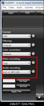

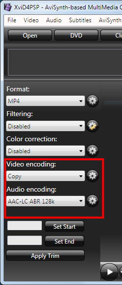

  2. In Xvid4Psp set Video Encoding to Copy.
  3. AVI to MP4 (with AAC audio, not MPEG-1 layer 3)

  6. If the video codec is acceptable to your TV then all you have to do is convert the audio. That should only take about five minutes with Xvid4Psp.

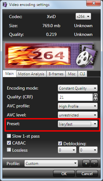

    If you have to convert the video too it will take much longer. You can greatly speed that up by using a fast preset in your conversion:
    The Veryfast preset for x264 shown here is several times faster than the default presets. You can go even faster with Superfast and Ultrafast.
