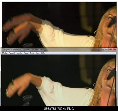

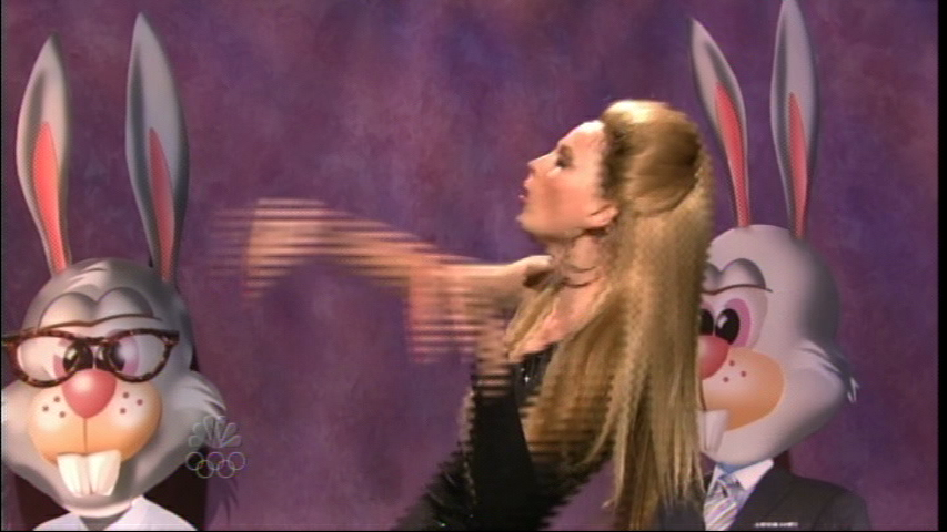

    OK did a quick test of Vegas with good results. I didn't have a 1920x1080 60p sample but have lots of 1280x720 60p.
    Source was a PBS 1280x720/60p MPeg2 broadcast captured direct as mts.
    I decoded the MPeg2 to Sony YUV 4:2:2 codec (720 60p uncompressed project).
    Then I exported a clip to 480i DVD at 9500 kbps CBR ("render as" 720x480, 29.97, upper field first)
    The upper picture is a frame capture of the 720x480i render. After 60p->60i conversion, both fields are distinct as they should be.
    I then played the 480i file in my Sony BVP player and stepped through frame by frame at 60p (post deinterlace) and could see all fields converted back to frames. The lower picture was recorded off the BVP composite output as a sample of the deinterlace.
    click on picture to see full size
    What this shows is Vegas Pro 10e can properly convert 60p to DVD 480 60i. It also shows a good progressive DVD/Blu-Ray player or HDTV can convert the resulting 480 60i back to 60p.

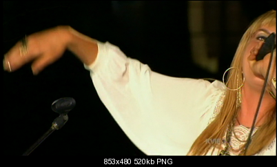

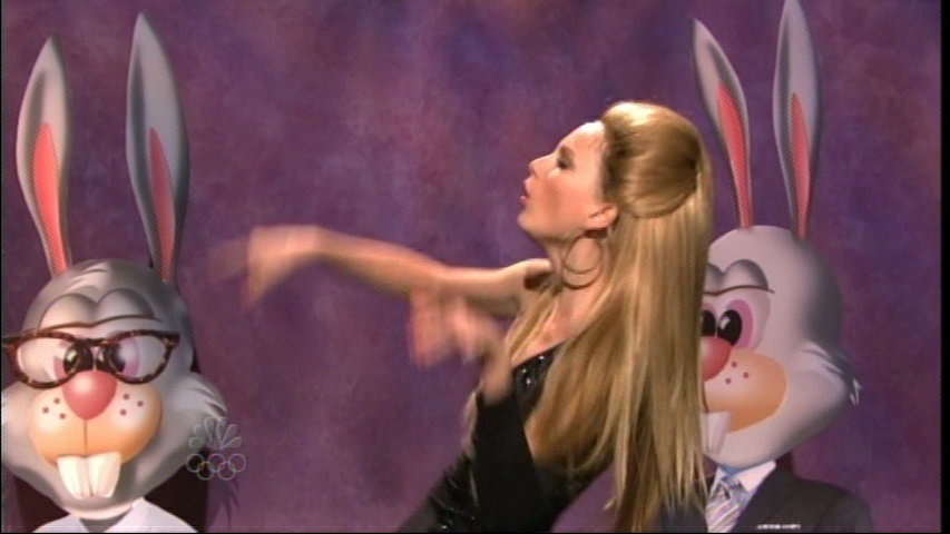

    PS: Here is the other field from the Blu-Ray player.

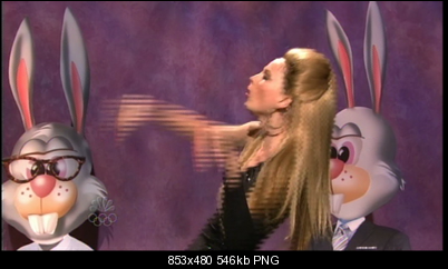

    While I had all this set up, I decided to run a 1920x1080 60i clip with similar arm movement through Vegas to show the difference between 60p and 60i source.
    For 60i source, Vegas will first deinterlace to 1920x1080 29.97p, then resize to 720x480 29.97p, then re-interlace to 29.97i (aka 60i) for DVD. Both fields will be taken from the same progressive frame so motion samples are cut in half. Worse than that are the deinterlace artifacts. Vegas will follow the deinterlace method specified in project settings.
    Deinterlace = None ... this shows typical interlace resize artifacts.

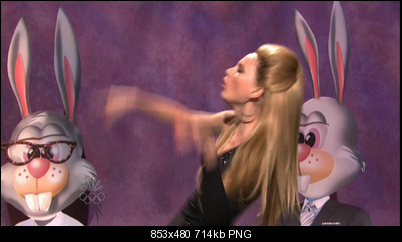

    Deinterlace = Blend Fields ... depending on motion, blend tends to show double imaging and smear.
