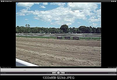

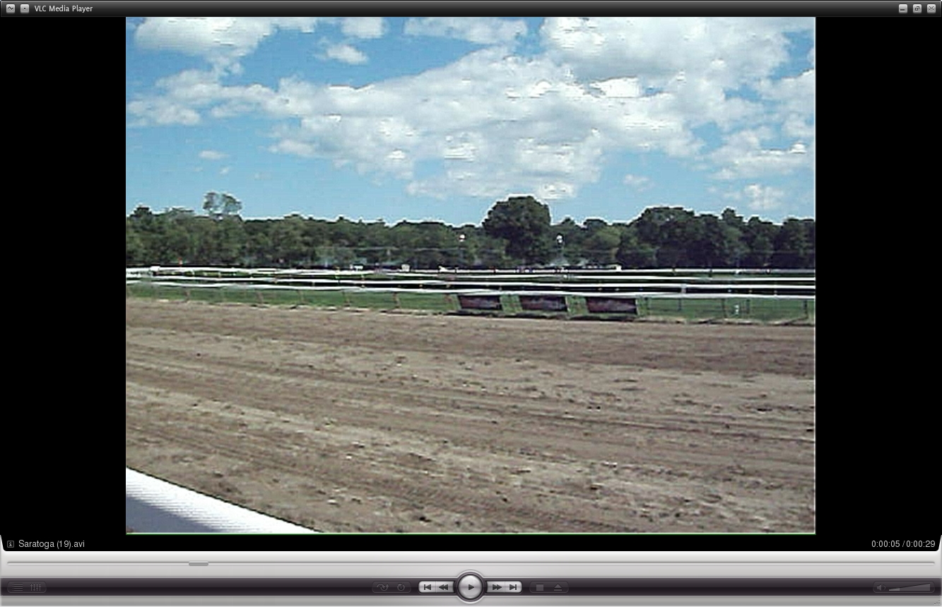

  3. Click image for larger version
Name:	slant lines on railings.JPG
ID:	8255 scrnshot off my pc note the jagged slanting lines on the track rails as the video rolls they move around some. AS you can see in the video as I pan across the scene the playback does this stop motion kinda thing every few secs. Even seems to do it as i record video on camera thru lcd preview . Cam settings are ntsc 640 or hd 1280 Battery level is full, option for digital or optical set on digital.

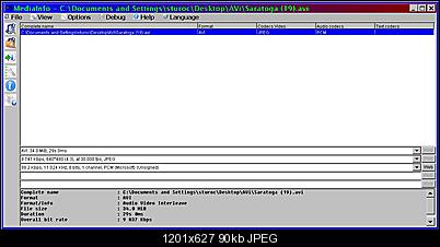

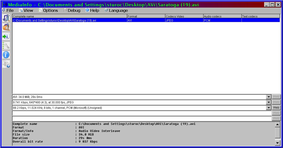

  4. Click image for larger version
ID:	8258 and here is the media info scrnshot

    PS - re: the mediainfo screenshot - much better to put it into view/text mode and post that.
  7. Do you have the deinterlacer in VLC turned on? That is probably the cause of the jagged near-horizontal edges. The youtube video didn't pause for half a second every few seconds here.

    lookup "rolling shutter distortion". it's a cmos chip problem. always use a tripod, pan slowly and never record from a moving vehicle.
