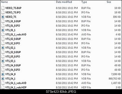

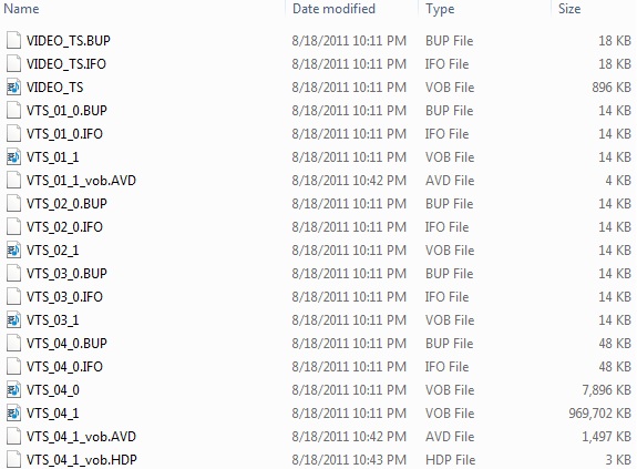

    Did the copies from DVDFab give you a VIDEO_TS folder?
    Feb 2008
    Yes, it did. And it also gave me an Audio_TS folder as well even though that folder is empty.
  6. Member hech54's Avatar
    Jul 2001
    Yank in Europe
    An empty AUDIO_TS folder is normal.
    This is what a DVD folder should contain:
    https://www.videohelp.com/dvd#struct
    You have some strange files in there.
