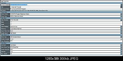

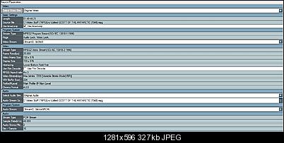

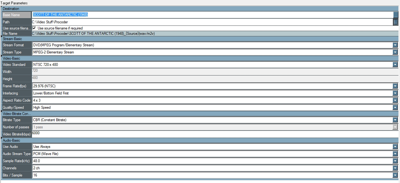

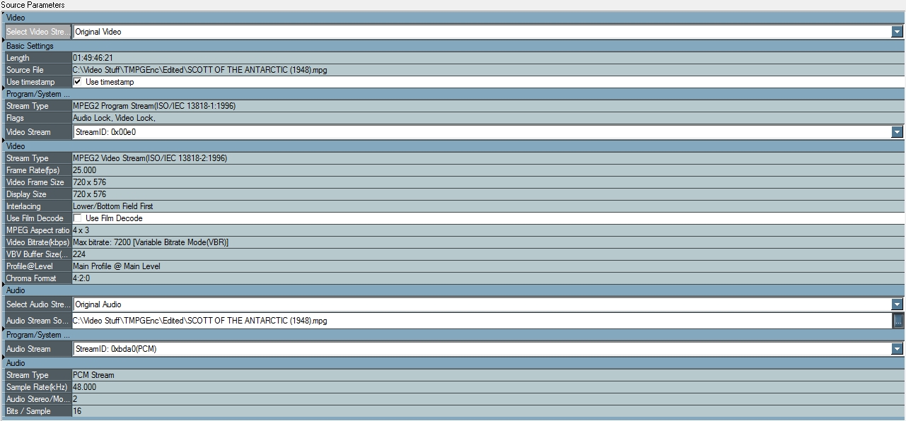

  4. As in the past, when I opened the file into Procoder I check the field order panel and if it is upper or lower I set the export to the same. Here are screen caps of both the input and output settings: Click image for larger version
ID:	8240Click image for larger version
  5. Probably procoder has made a mistake in identifying the field order. Perhaps it assumes all SD is BFF, when some are actually TFF. All HD is TFF => that is a safe assumption, but SD can be either
    If the export played back goes fwd, back , fwd, back, etc... => thats very likely the wrong field order as mentioned above
    You can determine the actual field order easily if you examine the fields separately (e.g. in avisynth)
    As manono pointed out, there are other rare bizzare cadences as well. Some DVD's have swapped field order , there is a transition point where it is TFF and later it's BFF. If you can't figure it out, post a native sample
