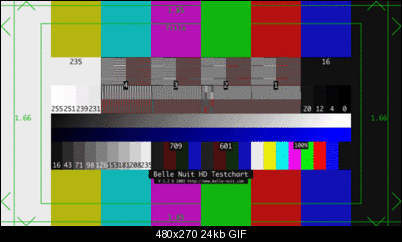

    I use 23" Samsung monitors for the Vegas/Premiere/FinalCut menus but always use video monitors to judge levels, gamma and color balance. You really need both waveform monitors in the edit program and a separate calibrated video monitor to get close.
    For SD I still use CRT interlace monitors (Sony PVM's). For HD I double-tripple check with a mix of levels calibrated CRT and LED HDTV sets because at this location I can't afford an HD broadcast monitor. All HDTV sets attempt to auto-adjust both levels and chroma balance. In some you can turn these functions off and you should to make color judgements of your video.
    Broadcast/Professional monitors are designed to accurately display your video as it is (warts and all) without auto-correction. That way you can fine correct visually.
    Computer monitors follow different gamma and chroma standards. It is difficult to get video accurate color on a computer monitor. You can get black and white levels close using test patterns such as SMPTE or Belle Nuit.
    http://www.belle-nuit.com/testchart.html

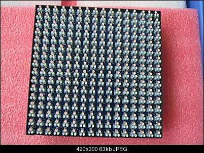

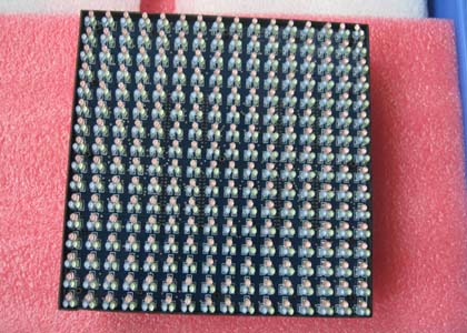

    Those jumbo stadium displays are true LED monitors. Those use a multi-color LED per pixel.
    Or a triad of three LEDs per pixel.
