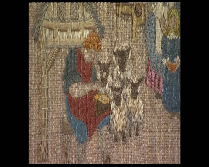

    Jun 2011
    Moon
    See attache Jpeg.
    Along the very top are the Teeth.
    Sometimes they are bigger than this.
  6. That looks like "line 23" data that flags the aspect ratio (and other stuff) in analog PAL video.
    http://en.wikipedia.org/wiki/Widescreen_signaling
    Look to disable an option for those flags.

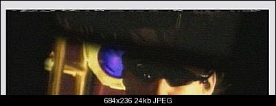

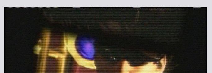

  13. Member edDV's Avatar
    Mar 2004
    Northern California, USA
    Is this similar to your issue? This is NTSC. PAL will look slightly different. Please post some frame caps or a small clip from the source video. VLC is a good choice for frame cap.
    http://www.kiva.org/about
