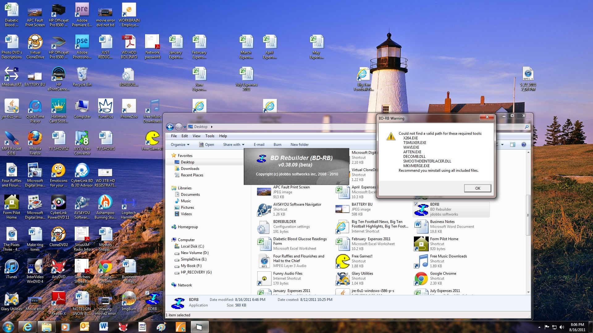

    I just downloaded the new version of bd rebuilder 38.09 and when I try to run the program a warning box pops up saying could not find a valid path for these required tools:
    x264.exe
    tsmuxer.exe
    wavi.exe
    aften.exe
    decomb.dll
    smoothdeinterlacer.dll
    mkvmerge.exe
    Recommend you reinstall using all included files.
    not sure what all this means or how to do it, can someone please help this rookie. Once I click on ok then the box pops up to put in the source path and working path and I fill that in and it says the error in attempt to extract audio/subs part. help. trying to rebuild bd movie ofcourse.

    not sure how to do that so i did a print screen to show you what i have, hopefully i did that right so you can see it. sorry for being so stupid.
Name:	bdrebuilder error print screen.jpg

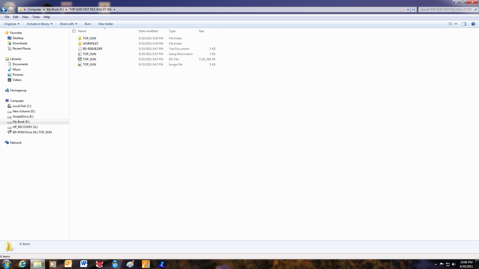

    ok, I finally got it thanks to everyones help on the forum, thank you. BUT, here is a test for ya. I have been trying to backup my movie TOP GUN with tom cruise and it is 47 gig in size so I shrink all my movies down to under 25gig using that option and ofcourse cking the box ONLY MOVIE, I don't want the other junk just the movie. so when I put the 47gig into the virtual drive and then destination is my external drive here is the picture shot I get, i will put as attachment so you can see and it doesn't record the movie, it gives me the HOW THEY MADE THE MOVIE and with interviews of the cast ect and not the movie, what is up with that. I have never had a problem shrinking my movies down under 25gig and just doing the movie only but with top gun it just copies the way they made it and with interviews. why is this different from all the other movies I hve done this with, ck out the attachments.
Name:	top gun print screen.jpg
