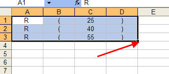

  1. You identify the 1st frame to be replaced, eg. check in avspmod
    Enter the values for the 1st 3 entries, in this example it starts at 25 (randomly chosen). So drag a marquee box around the data and drag down the bottom right corner until you reach how far you want to go (you know the total #frames from previewing in avspmod) . Copy & paste that into the relevant section in the .avs script
    It's faster if you use gavino's method, and you don't have to figure out how long or how far to go. You only need to identify the 1st frame to be replaced, then adjust the 3 lines
