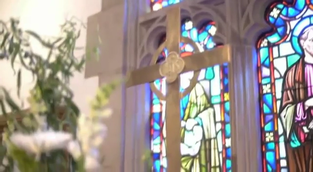

  5. I would use avisynth, but there is a bit of learning curve. You would apply the script and transcode to an intermediate (e.g. cineform, dnxhd, or some lossless format like huffyuv, lagarith) then import the clips into your NLE
    Because the "bad" frames occur exactly 15 frames apart it's easy to replace with a blend or interpolated frame
    You can generate a text list in excel or google spreadsheets by entering the 1st 3 numbers then dragging the box, and it will autofill (every 15th frame)
    23
    38
    53
    You can use fill in the function and brackets, and it will autofill as well, so all you have to do is copy & paste. It will look something like this
    Badframes (23)
    Badframes (38)
    Badframes (53)
    The third option I talked about is motion interploated frames. There are some functions called "R" , "RP", and "RX" , for replace 1 frame, replace frame pair and , replace a string of frames. Single frame is all you need
    The difference is the replaced image won't be a "dumb" blend, it will use optical flow to generate an "in between" frame
    I posted examples screenshots and videos illustrating the differences . For the screenshots, I chose frame 128 at random, the first uses badframes(), the other R(), you will see R() is less blurry on the repaired frames
    The problem with motion interpolation, is you can get weird artifacts from the interpolation. With slow controlled movements like those in your clips , it's usually not a problem. With action like sports, it can be a problem - then you can use BadFrames() instead (or you can mix & match)
    (You're probably lost if you are new to avisynth, so don't be afraid to ask questions, someone here will help you)
