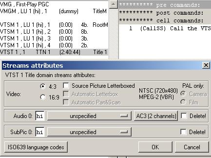

  15. I just tried opening the IFO in AVStoDVD, and it still thinks the original should be 4:3. I've downloaded PGCEdit, but it won't work with the IFO and VOB on my hard drive. I'm not prepared to mess around with the actual original DVD -- I didn't even realize that could be edited.
    Is there a way to change the IFO on my hard drive so that it reflects the 16:9 aspect ratio? Perhaps a setting I'm not aware of in DVD Decrypter that would produce the proper results if I ran the DVD through it again? Or what about a way to convince AVStoDVD to produce a 16:9 DVD image that didn't get there by simply pasting black bars over the top and bottom of every frame?
  16. @Djheuti,
    to change the IFO aspect ratio flag: IfoEdit (guide)
    to change the VOB aspect ratio flag: DVDPatcher
    to bend AVStoDVD to your will:
    1. go to 'Edit Title'/'Video', toggle off 'Auto Video Setup', select 'Widescreen (16:9) as 'Video Aspect Ratio'
    2. go to 'Edit Title'/'AviSynth', toggle off 'Auto AviSynth Script', select 'Vertical Resize' and insert '75'
    Bye
    MrC
    AVStoDVD Homepage
  17. To do it using PGCEdit, open the final and reencoded DVD made by Avs2DVD in PGCEdit. Find the movie in the left panel and right-click on it followed by hitting 'Domain Stream Attributes' Then check the DAR. If it says 4:3, change it to 16:9 and Automatic Letterbox. OK your way back to the main screen, save your work, and test before burning.
