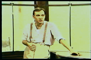

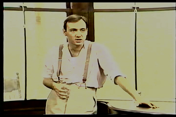

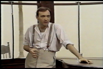

    Someone put too much brightness on a video I'm working on. It's the movie Long Day's Journey Into Night (1986). I don't have the original anymore and I need to bring it back to the nearest appearance as its original brightness/contrast/colors.
    I'm trying with VDub filters, but the result isn't satisfatory. The light areas refuses to get darken. Also, the balance of the whole colors looks wrong and crap.
    Below are some samples:
    Original bright image
    ffVDub Luminance offset -70
    ffVDub Gamma Correction 0.40
    ffVDub Levels input 80-255 Output 0-180
    Internal Brightness/Contrast -30
    CollorMill (some settings)
    Near to desirable image
    May you, guys, point me what I'm doing wrong, or suggest another tools/techniques?
    Thank you.

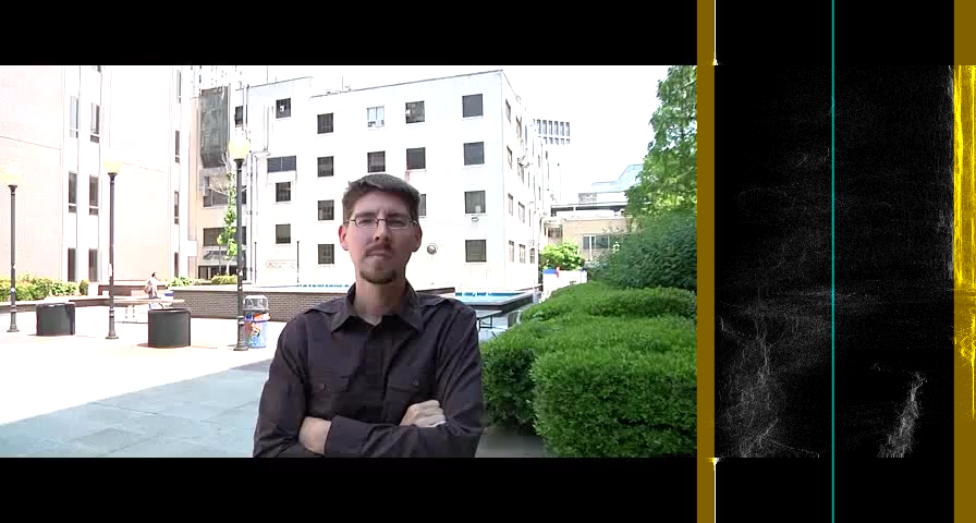

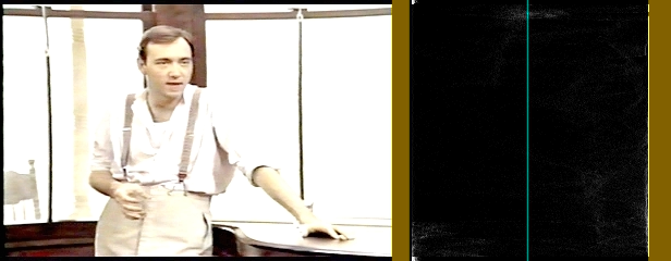

  6. Poison,
    if I put histogram() before ConvertToRGB(matrix="PC.601"), I get an error (YUV data only).
    When I put histogram() after, the graphic stays on the right side:
    Where is the hardline and Y axis? How to work the color correction?
    Thank you.
  7. If you used
    MPEG2Source()
    Histogram()
    Then it's clipped
    Histogram() is turned over on it's side 90 degrees clockwise rotation. Do you see the hard white line? That is clipping at Y=235
    A video that had superbrights and superdarks retained would have values in those brown areas. Those brown areas are Y' 0-15 and Y' 236-255

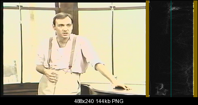

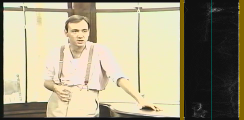

    If your monitor is calibrated, then look at the screenshots. You should see 235-255 as a big white bar (there are no demarcations between 235-255). The reason is when you view something, it has been converted to RGB using a standard range matrix (you're not looking at YUV, you're looking at a RGB converted representation of it).
    If you preview in vdub or avspmod, any media player, they will use rec601 or rec709 to convert to RGB for display. This means Y' 16-235 gets converted to RGB 0,0,0 - 255 ,255,255. White is at RGB 255, black at RGB 0. But what happened to all that data from 0-15 and 235-255 - it's gone
    If you look at your screnshots, there are "folds" in the shirt, but all that detail is gone in the bright picture. It's the same thing, there are no separation becaues all that data has been clipped . It all resides at Y=235 now, where that line is a straight white line on the histogram
    Open the full range yuv file and use histogram(), and you will see data in those brown regions. So although the preview you are seeing only shows Y' 16-235, there is data in those ranges. Compare to your video, there is nothing in those ranges.
    AVISource()
    Histogram()
    Now try converting to RGB
    AVISource()
    ConvertToRGB()
    - because no matrix was specified, you see the exact same thing, 0-15 is a bar, 235-255 is a bar (no detail). It's clipped just like your video. Not recoverable. If you open the video directly in vdub, same thing happens. Nothing you can do to return those demarcations - go ahead and try - (unless you work in YUV, or use full range RGB conversion)
    Now try convert to RGB using full range
    AVISource()
    ConvertToRGB(matrix="pc.601")
    - because you are now "mapping" Y' 0-255 to RGB 0,0,0 - 255,255,255 , you see all the information. It's not clipped.

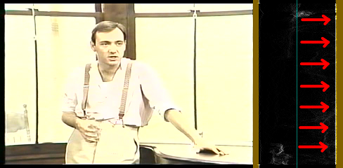

  16. Once again, thank you for the great lesson.
    Now, I guess I'm a little bit less dumb than before.

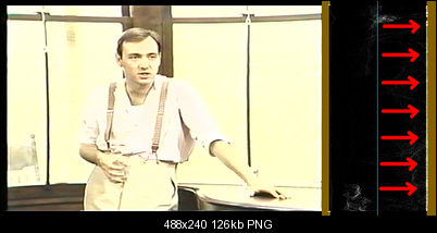

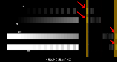

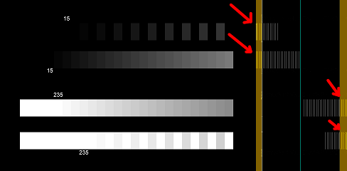

    Converting to RGB drives me to loose some superbright and superdark data, because the video already has none.
    Arrows shows data < 15 and > 235
    No useful data to recover
    But, reaching the end of our lesson, what do you suggest to use to kill that excessive brightness. Color Mill, Levels, Gradation Curves? Any suggestion for settings?
    Thank you.

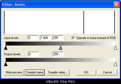

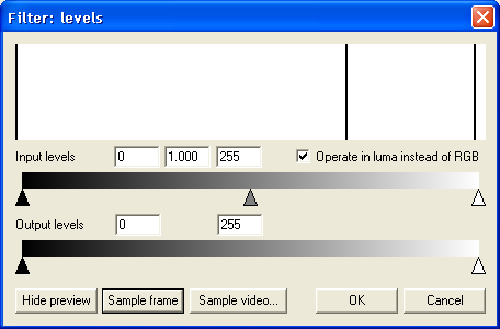

  19. VirtualDub's Brightness/Contrast filter can work in YUV. Use it as the first filter in your processing. Enable the "Show image format" option in the Filters dialog to verify the image is in YUV at that filter.
    But I think your source (the very fist image) is too far gone.

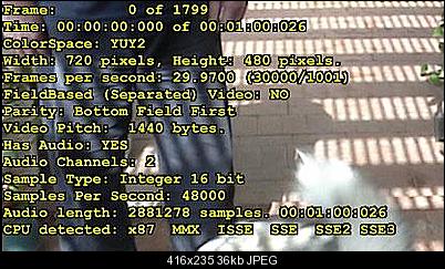

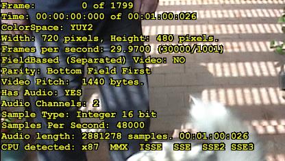

  22. First make sure your source is being decoded in YUV: add Info() right after WhateverSource() in AviSynth. That will print information about the video source on the frame.
    AviSource("filename.avi")
    Info()
    If you see YUY2 or YV12 then check VirtualDub's Video -> Color Depth settings. I usually force the input to YUY2.

    Poison, I couldn't use your samples. AvsPMod and plain script in Vdub returned "Could not decompress frame 0" error. Opening directly in Vdub I got just a green screen and the following levels (color deph 4:2:0 YV12):
    I want to give a try and use the proper workflow, but what do you mean with that?

  26. That video is hard clipped at Y=235 (except for a little noise). You can darken it but you won't be able to bring out any more details in the bright areas.
  27. Originally Posted by jairovital View Post
    Sorry , not sure why? Maybe it was corrupted upload, or you have problems with xvid? I'll upload it as huffyuv
    By "proper workflow" , I mean you don't inadvertently clip it in your workflow. That's the one of the reasons for these exercises. If you just import the video as is and work in vdub, the superbright information will be clipped in the YUV => RGB conversion. Even something like Premiere or After Effects will clip the information if just import it as is - they don't handle XviD or HuffYUV as YUV ,they treat it as RGB and clip the information. Either 1) Your software and filters have to be able to access YUV or 2) you use full range in your RGB conversion if you are working in RGB
    Here is another example. Someone in another forum was asking questions about exposure and lighting, and how he could have controlled the exposure better (maybe with lights, reflectors) - but let's say you can't reshoot it and it's all you have . It's a bit more challenging because of different exposure in the frame. The background is overexposed, but the foreground isn't. So a linear correction that improves the background will make the foreground too dark. More selective color correction technique would help here, like curves, secondary color correction etc... because you can target different areas separately. Traditional 3-way color correctors would target highlights, midtones , and shadows.
    You should be able to improve the background detail . The building on the left is supposed to be red brick, the lights are supposed to be yellow/orange, you should be able to see the water in the fountain, the outlines of the buildings are obscured as well, you should be able to improve them.
    This was originally a youtube video , but link is down. I converted a few frames to Huffyuv and labelled them clip 3 and 4: (3) with superbrights preserved, (4) clipped
  28. Poison, we almost there. Now I did can see precisely what I'm loosing when I open the video as is. I think, for my learning purposes, Vdub is enough. I have no access to 3-way or After Effects.
    In 1.superbrights.test.huffyuv.avi I can see more details of the clothes at the input video pane than the output. I adjusted Color Depht to 4:2:0 as you said, but it is the same as "autoselect" setting. Left pane has more details.
    Thank you for the second example (Youtube), about fore and background lighting problems. Using Photoshop I know how to handle that, but video is something different.
    As jagabo had affirmed before, Internal Bright/Contrast works on YUV. My idea is to do just some Levels after Bright/Contrast.
    So, I have just 2 questions:
    1 - Why input pane has more details than output? YUV x RGB?
    2 - How to input as YUV? Just set Color Depht to 4:2:0? How did you create the sample without clipping superbrights? I want to do the same and accept as a happy-end.
    Thank you.
  29. In 1.superbrights.test.huffyuv.avi I can see more details of the clothes at the input video pane than the output. I adjusted Color Depht to 4:2:0 as you said, but it is the same as "autoselect" setting. Left pane has more details.
    there should be no difference between panes if you just open the video in vdub (no filters)
    disable direct x : options => preferences => display => uncheckmark use direct x for display panes
    Actually it's exactly the same, if you are working in RGB . If you know how to use RGB levels in photoshop it's the same in vdub, in avisynth, in ae, etc... input white, input dark, gamma, output white, output dark
    RGB Curves in photoshop is the same in vdub, in Ae, in premiere etc...
    The difference here is your video is starting out in YUV, and most color correcting filters work in RGB . If you're not careful, you can clip information even before you start
    Only some filters work in YUV for vdub, most of them work in RGB . To input as YUV, make sure you are frameserving YUV if using avisynth (use info() ) . File=> file information may also report what vdub is "seeing" . You may have to use color depth option as well, then check the filter list (show image formats is checkmarked)
    To create the 1st sample, I increased brightness and gamma in RGB, then I conveted back to YUV with full range matrix
