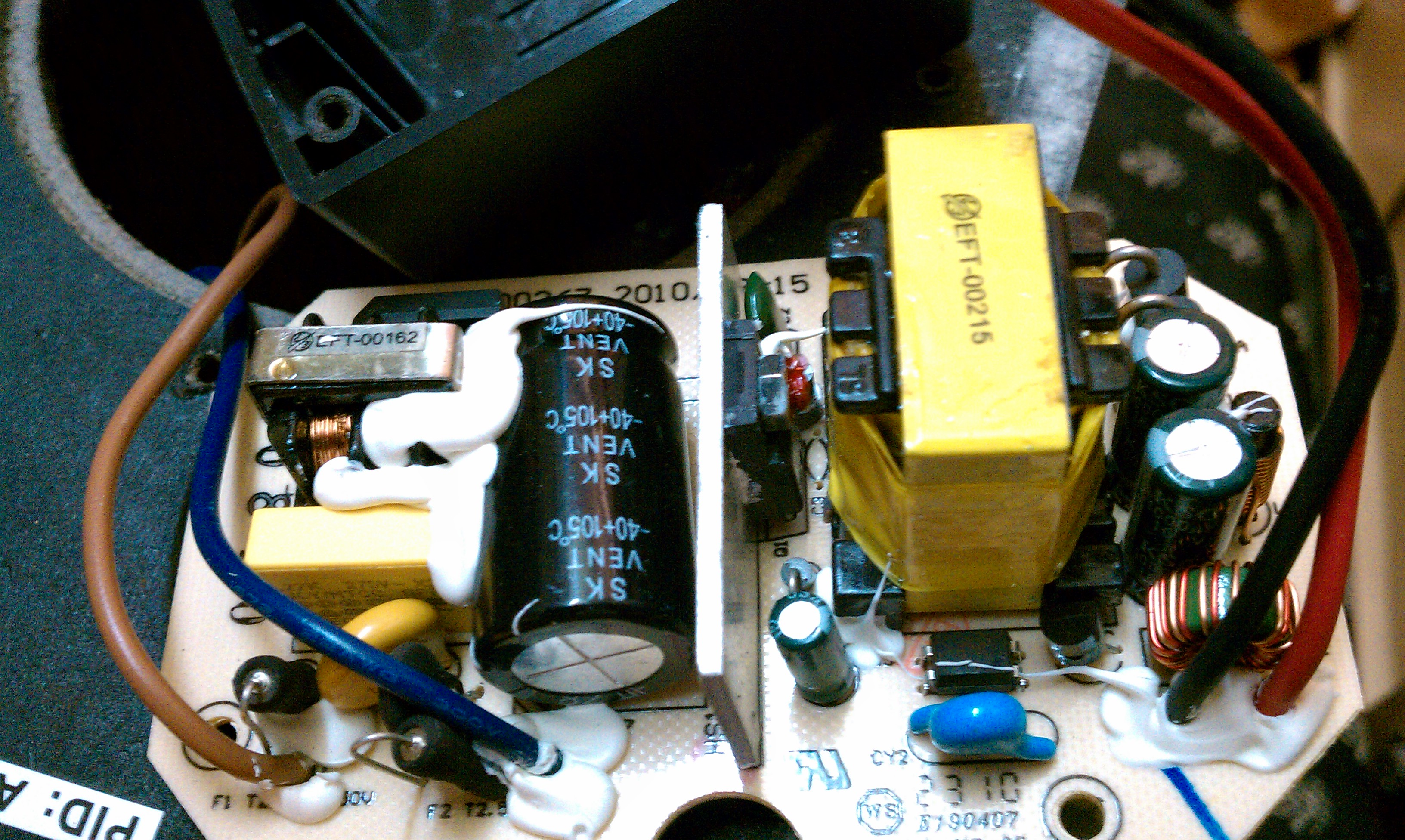

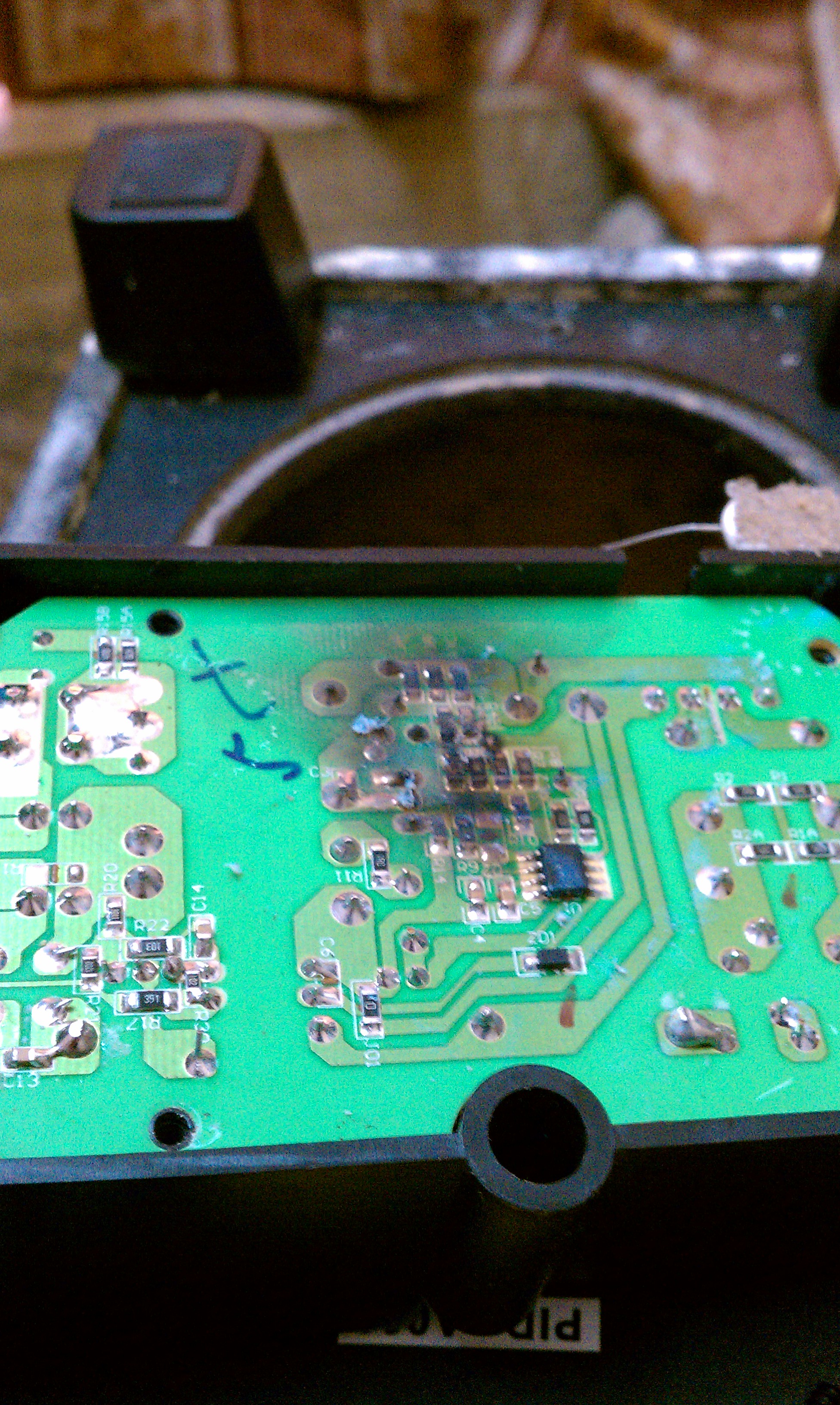

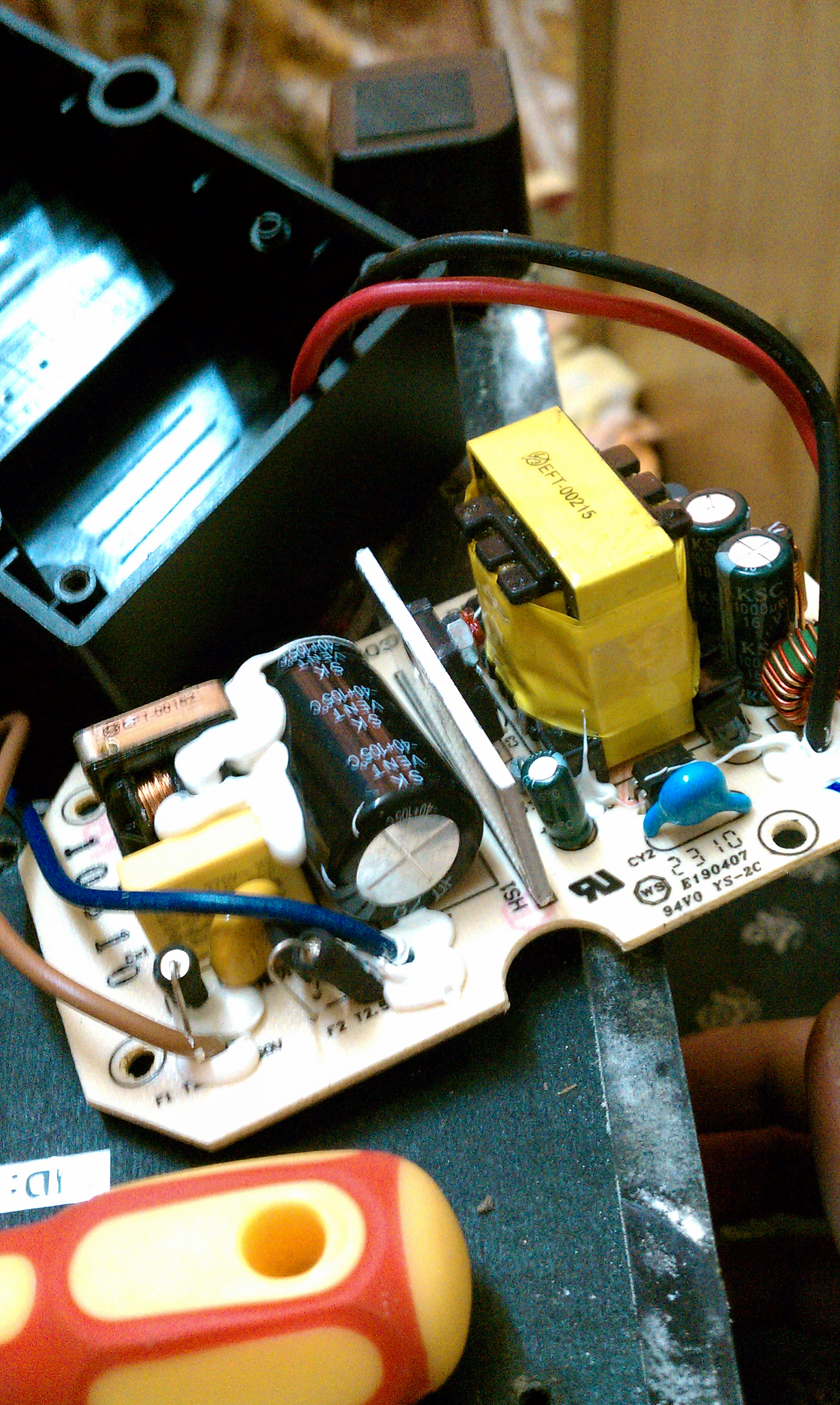

  1. When i powered up my pc yesterday, i heard a tuck sound from my logitech z313 sub-woofer and i saw a bright spark on my surge protector. I immediately turned everything off. Checked the surge protector, everything looked alright, no black/burnt marks seen. I then plugged everything back in , booted up my pc and everything seemed to work alright but my speakers ! I couldnt power them up. I knew the tuck sound came from the woofer, so i decided to open it up, as the warranty period has expired. When i opened it up, the pcb looked alright, but the other board, i dont know what its called, had a burnt mark. I have attached the images , please have a look and let me know whats wrong and if it can be fixed by some soldering etc.

    That looks like a voltage regulator on your power supply module. Also looks suspiciously like the full AC line voltage did that. I suspect it's well beyond repair. If your PC plugs into the sub and the satellite speaker wires come out of the sub, not really worth messing with. I suspect the amplifier that feeds the satellites also blew out, along with the voltage regulator and a few other parts. Just be happy you didn't get a fire.

    This is an old thread, but this is a common issue with this Logitech Z313 and similar speakers and I suspect that a lot of people have this problem.
    To repair this problem could be easy and inexpensive. The problem is that there is soldering involved and some of the connections are at mains voltages so don't attempt this if you are uncomfortable or not knowledgeable about dealing with circuits at 110/240V.
    Always disconnect from the mains power by removing the plug from the socket and also disconnect all connections to the computer before opening the sub-woofer casing.
    The casing contains a large speaker, an amplifier circuit and a separate power supply unit.

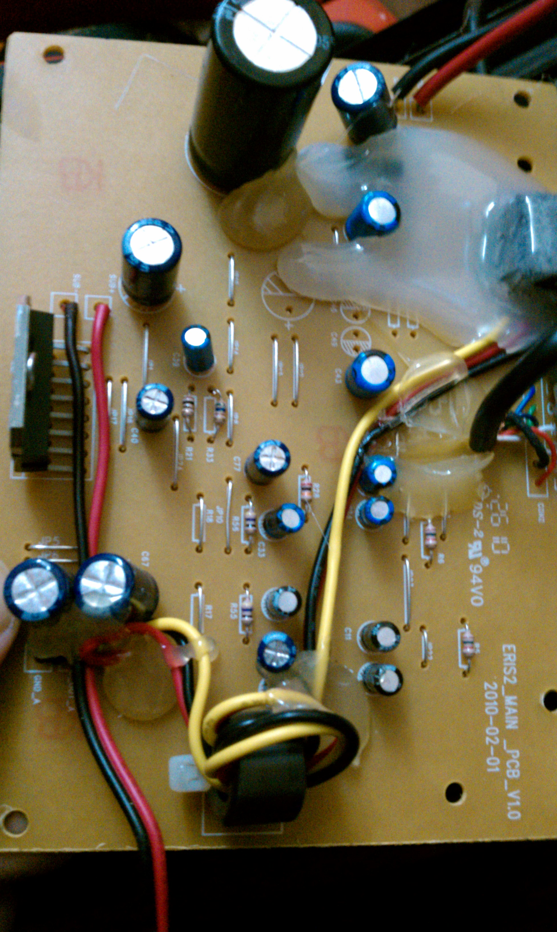

    The first three thumbnails are pictures of the separate switching power supply unit circuit. The cheap components in these circuits fail causing the power-supply to stop working. Usually the power transistors are over-driven and short circuit on power-up as described in techsparks post. This almost always causes a surge on the mains side of the circuit which may blow the mains fuse, trip mains circuit breakers or as in techsparks case, fuse the disposable surge protector. The 12V side is isolated from this mayhem and the separate amplifier circuit is usually undamaged. It is therefore possible to repair the speakers by replacing the power supply unit. It is impractical to repair these power supply units, as can be seen from the third picture, damage to high voltage components can be wide spread and severe.
    In this case it is clear that the power supply has failed. Failures may not be this dramatic and obvious so it is wise to test other parts of the system to verify that the power supply is the problem before you buy a new one.

    Is the amplifier working?
    The amplifier can be tested by connecting it to an external 12V power supply. The separate black and red wires at the bottom right of the first picture is the 12v output from the power supply and you can see the other end going into the amplifier at the top right of picture four. Disconnect the red and black from the power supply and connect them to you external power supply, in the right polarity, (Red + Black - ) using whatever connectors you can make work. Be careful not to confuse the joined figure 8 red & black wires going to the speaker at the bottom of picture four. You are looking for the green indicator light on. Don't run them at a high volume. The amplifier can draw about 160W which is about 12A at 12V. Most external power supplies will be wall wart type which are usually capable of less than 1A.
    You can buy 12V 160W power supplies to run led lights or security systems for about $20 on the internet. There is an issue with the size of them. You can buy small form ones which will fit inside the casing but they are more expensive. The larger cheap ones may need to be mounted on the outside of the casing. They are metal cased so need to be earthed so the mains cable needs to be replaced with a three core flex. These are easy to get. Everyone I know has an old IEC cord from an old computer or monitor which you can cut the IEC end off.
