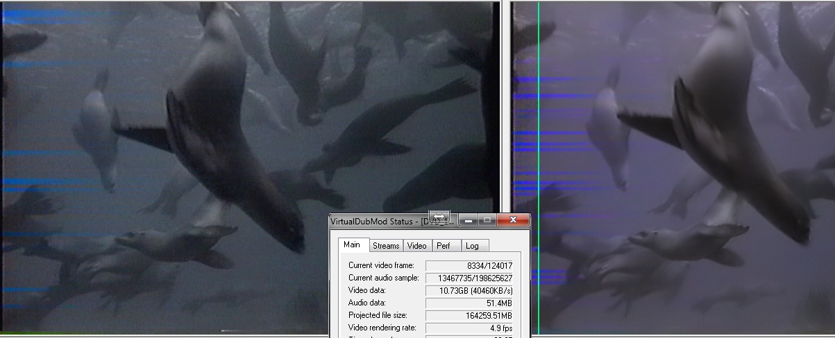

    I'm pretty new to VirtualDub and Neat Video. I'm trying to clean up a VHS tape and I have gotten the general noise down a good bit and changed up the color a bit. My problem is that this VHS tape has colored horizontal lines coming from the left side through out the video. Every time I try to compensate for it in a sample frame (s), another area further in produces the same type of lines, just in different colors and in different areas. I can seem to get these lines reduced through out the entire video. Some times the lines are blue, some times red, near the top, in the middle, near the bottom....... It's always changing.
    I do not expect to get rid of them entirely or anything, but I'm just wondering if there something I could do the reduce them better through out the video. When I clean up one area it seems to make another worse. I can actually get rid of them entirely, but only by dropping out the color so much that the rest of the video is almost black and white.
    I attached a sample to show the type of lines I'm talking about. I'd appreciate any suggestions.

  2. It's going to be hard to get rid of those discolorations. And you'll probably have to use AviSynth to have any hope of doing it. Do the discolorations move with each frame? Does the color change with each frame? It's probably best if you provide some sample video sequences with a range of shots.

    head cleaning tape? or a different vhs machine maybe.

    I agree with aedipuss, if the color distortions are not constant i'm inclined to believe that there may be a problem with in the capture set up. Such as dirty heads on the VCR a head cleaner can be had for around $10 bucks or so at wally world. I would clean the heads then try the capture again. And make sure to use a good quality cables.
    Oh and make sure the cables are not with in range of any thing that could case some type of interference speakers, ham radio, radio, etc these types of items can be picked up in the cables and induce distortion in the signal. Unless you are using shielded twisted pair.

  8. RemoveDirt in AVISynth may zap those out. In that snapshot those lines are a color that does not exist anywhere else in the frame. Masking in Vegas would not be too dificult.

    Be very careful with head cleaning tapes -in fact, stay away from them!The anamorphic heads on the Panasonic are soft metal that a cleaning tape can ruin almost instantly. They cost about $400 - $600 to replace, if you can find parts. Good head cleaning fluid is sold aqll over the internet, along with special tools to apply it. Cheap, compared to replacement heads.
    Those horizontal streaks look like video head problems. I've never seen anything like the blue vertical line. If they are constant and never change shape or location, no denoiser will recognize it as noise. Anyway, it's hard to gell from a single frame capture.

  12. Good points sanlyn. I never use cleaning tapes. Read about popping the hood ov that deck and swabbing the heads. Basically you need proper swabs and fluid, and most critical; in whitch direction to clean the heads. I usually hold the swab steady and manyally turn the head, instead of movign the swab. Use swabs 1 time and disgard, this is not where you want to be cheap and try to recycle. I also wear a latex glove on the hand turning the head. Make sure you clean the whole tape path while you have it open.
    Hopefully it's not a bad head. It could be a problem with that one tape.
