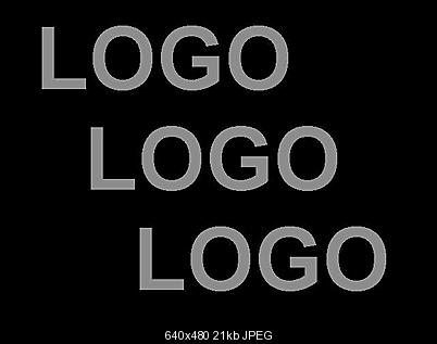

    Here's an example for budwzr. I made a video with a big logo like the OP's original. It started from a black frame so I had a reference frame at frame 0:

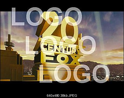

    Here's frame 200 from the video:

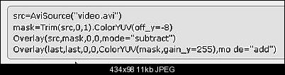

    Here's the same frame after this script:
    src=AviSource("video.avi")
    mask=Trim(src,0,1).ColorYUV(off_y=-8)
    Overlay(src,mask,0,0,mode="subtract")
    Overlay(last,last,0,0,ColorYUV(mask,gain_y=255),mo de="add")
    Obviously, you won't always be able to find a full frame of black with the logo but with smaller logos you can usually find a frame with the logo over black, export that as an image, blacken the rest of the frame, then use that as your reference.
    That exact script won't work in the general case. Only in the specific case where a bright white logo was blended with the source 50:50.

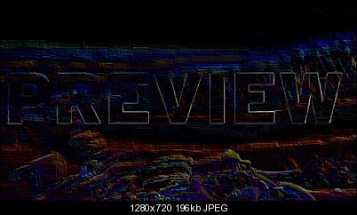

    OK, I found a method that eliminates the handwork. Still fine tuning, here's a rough taster:
    The idea is to bump it, then hit it with light from 4 angles and composite. This one is only lit on two sides. Note that the edge roughness is captured.

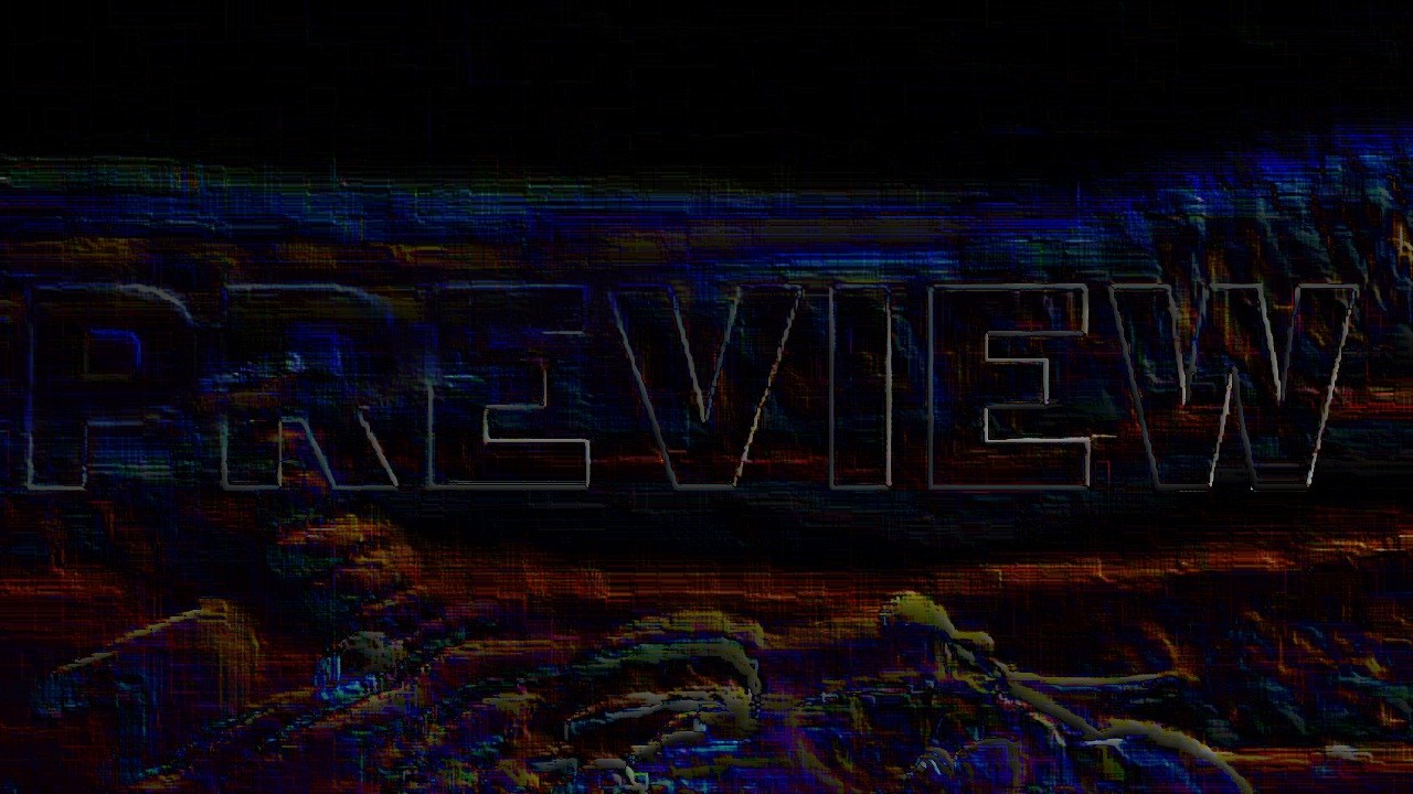

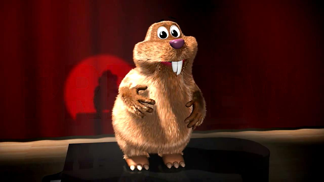

  8. This script:
    src=DirectShowSource("rene.mp4")
    mask=Trim(src,0,1).ColorYUV(gain_y=15)
    Overlay(last,last,0,0,ColorYUV(mask,gain_y=225),mo de="add")
    worked pretty well with one of the OP's other videos (I used the 720p version):
    http://www.youtube.com/user/JAMBAberlin#p/u/21/EUSacgT1mM8
    [Attachment 8265 - Click to enlarge]
    Some fine tuning of the two ColorYUV() lines could probably clean it up even more. Note the first frame of the video has the logo on a black background and I used that as a reference.
    I suspect LogoTools could do just as well if you use some of the advanced features. NoLogoAuto() left a bit of the logo behind.

    No doubt that a clean static logo can be satisfactorily removed using a script like that, and increasing the gain.
    However, the "tiger" clip had compression blocks randomly changing the outline, so basically the edge of the logo was constantly in flux. So intracube dealt with that using a separate outline which I thought was brilliant, only there was no mention of the attributes of the outline.
    But I suspect that it was feathered on the outside. That was a really sweet workaround.

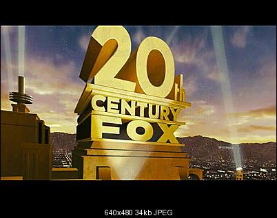

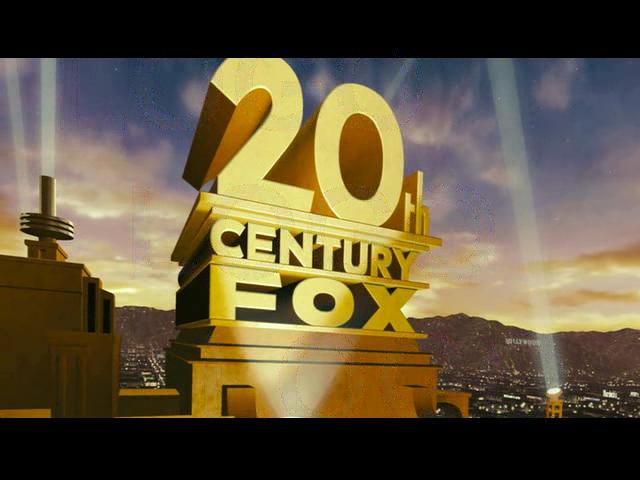

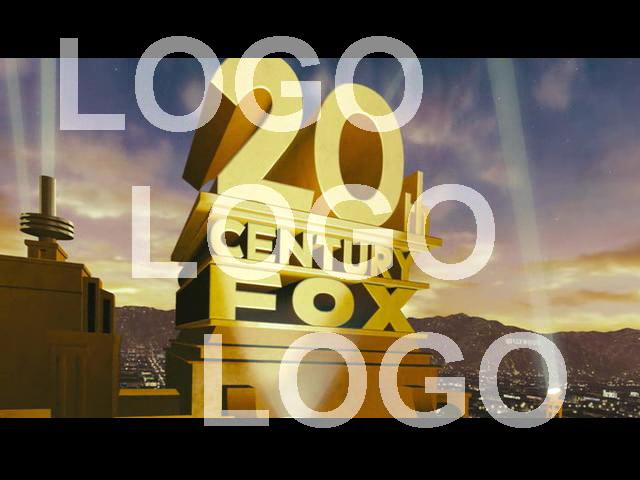

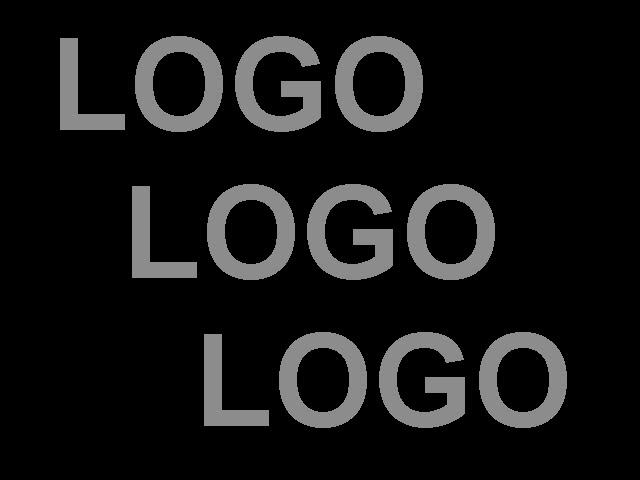

    looking at jagabo's 20 centry fox logo example made me realize something that didn't occur to me in my previous attempts let alone in today's. anyway. a closer look at the logo gibblets made me see the light.
    say you have picA (the scene) and
    picB (the logo you want overlay or make semi-transparent over picA)
    to make picC
    in theory or actual practice, when you create picC, you should be able to reverse it without error.
    (that is, extract (demux) into original picA and picB from picC)
    however, when you compress picC, i.e. jpeg or mpeg, you now have picD, because of the compression aspects that go into creating picD--its a new image. the ringing or gibblits around the edges is one of the major problems of reversing the transparency.
    i would like to double-check this using code from my old project with the new set of calculations you guys supply.
    so i'm asking, what is the exact calculation for creating a logo as the transparency, and the method to merge the two images into the finished product ?
    what i want to do is prove to myself that this true or false. can someone please help me with this ? thanks in advance.
