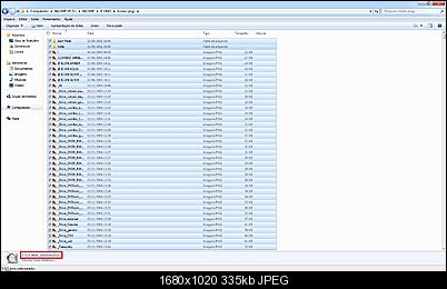

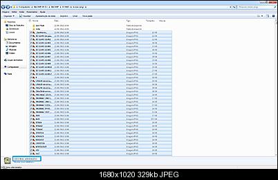

    Strange Cornucopia because using Attribute Changer I change 1000 files at sametime. No problem for me.

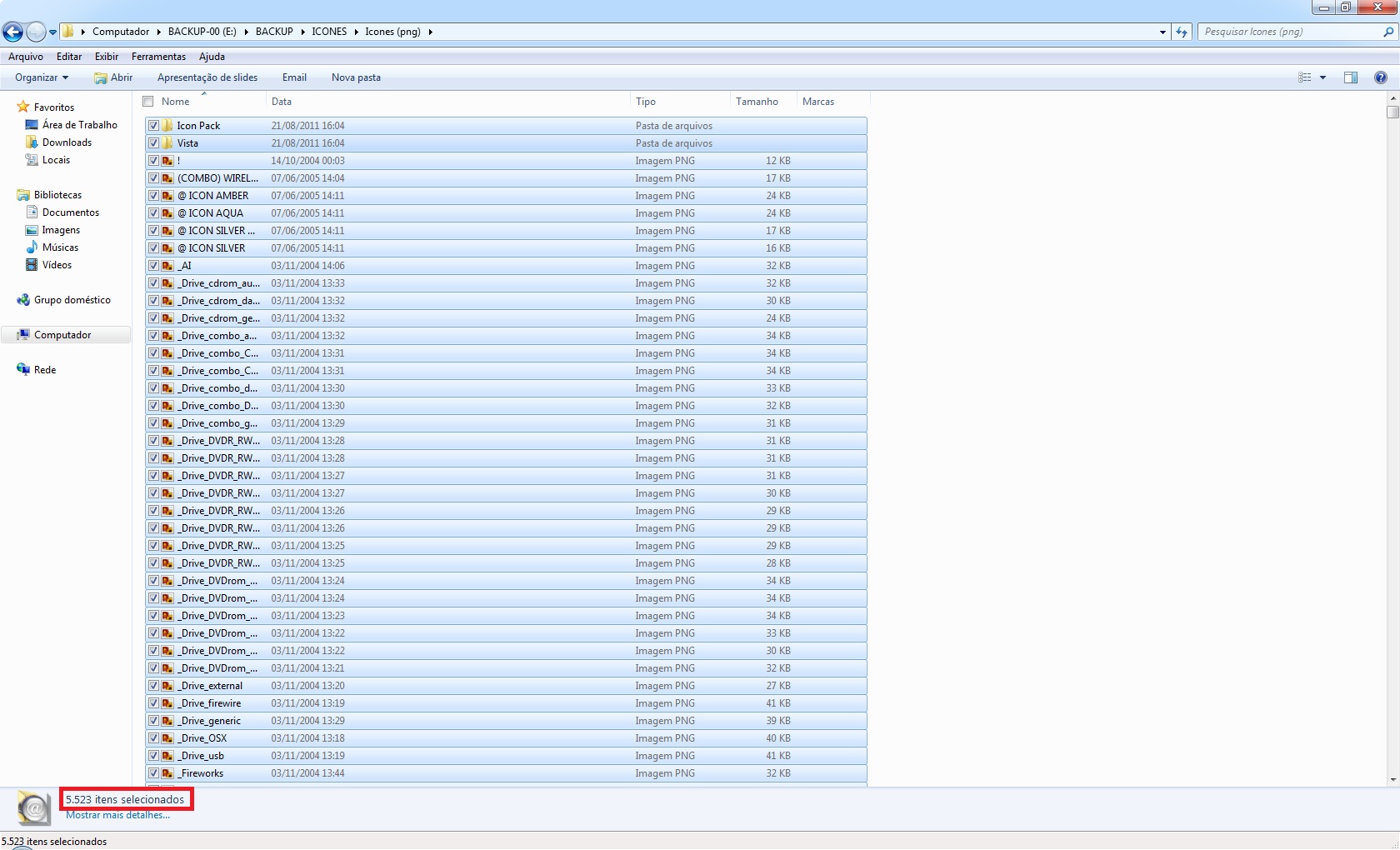

    +5000 files selected

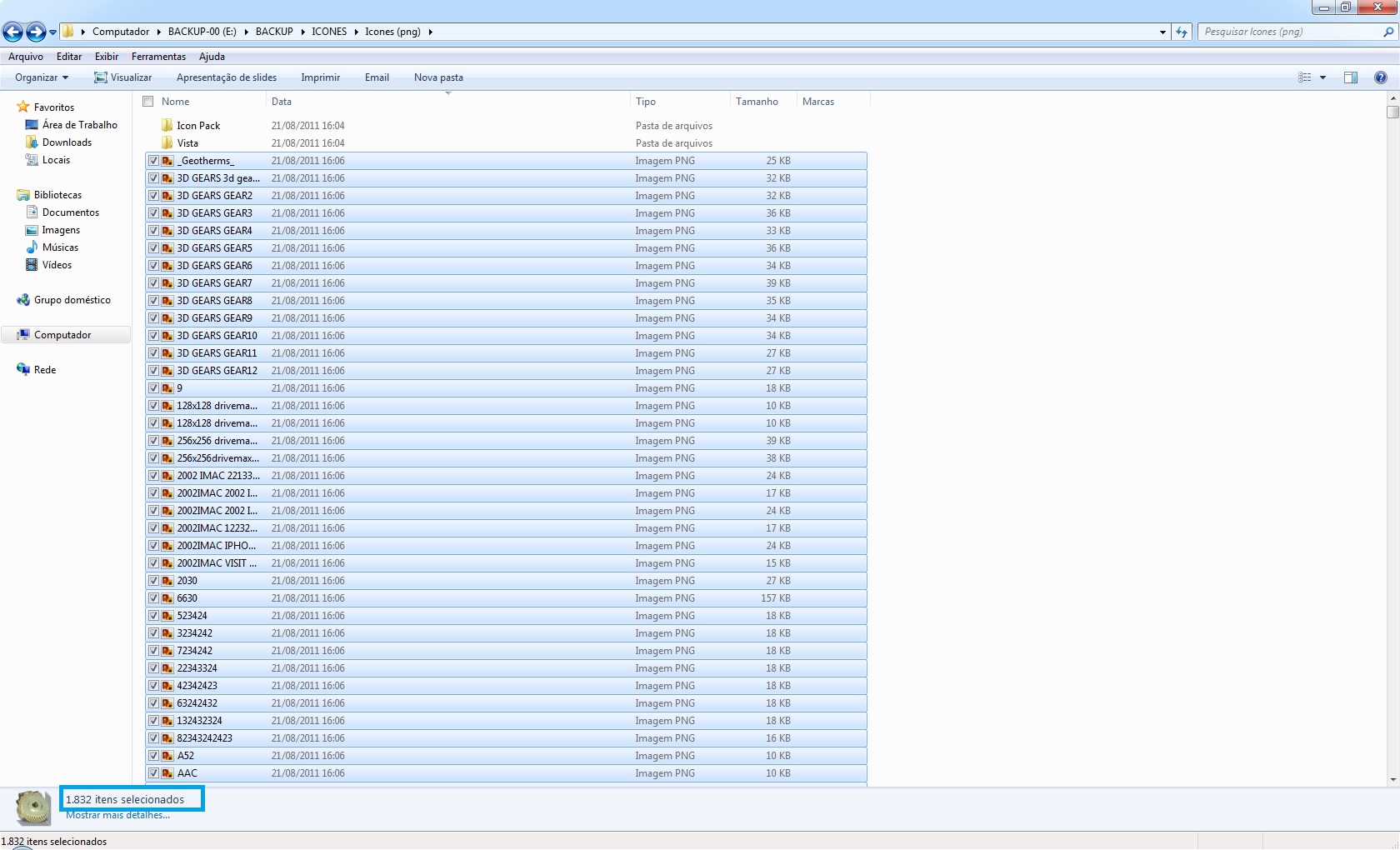

    +1500 files changed
