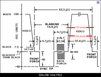

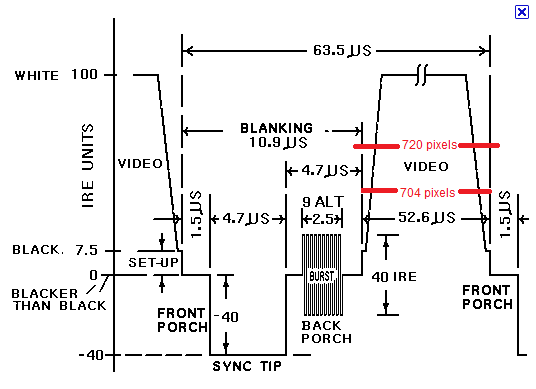

    The 8 black side pixels usually result from capturing broadcast video at 720x480 rather than native 704x480. The black pixels are actually captured 0 IRE blanking. The inner 704x480 contains the correct 4:3 or 16:9 aspect broadcast image. If one desires to convert 4:3 source to square pixels, the correct procedure is to first side crop 720 to 704 and then resize 704x480 to 640x480.
    If instead you rescaled 720 to 640, the resulting frame is somewhat horizontally squeezed with ~7 pixel side bars (8*640/720=7.11). To restore aspect ratio, one would crop 7 pixels off each side and rescale the remaining 626x480 to 640x480.
    NTSC capture
    Note that the side bars are not 7.5 IRE black but blacker than black 0 IRE blanking. After capture, black is at digital level 16, blanking is at digital level 0 and white is at digital level 235.

  10. Originally Posted by edDV View Post
    [Attachment 8117 - Click to enlarge]
    So if I needed to crop 10 off of each side instead of 8 because of dot crawl or something would it be best to stretch it to 640x480 and thats it, or would it be better to cut 2 pixels off of the top and 2 off of the bottom to make it 4 extra off the sides and 4 off the top to match? or should I leave the height alone regardless?
