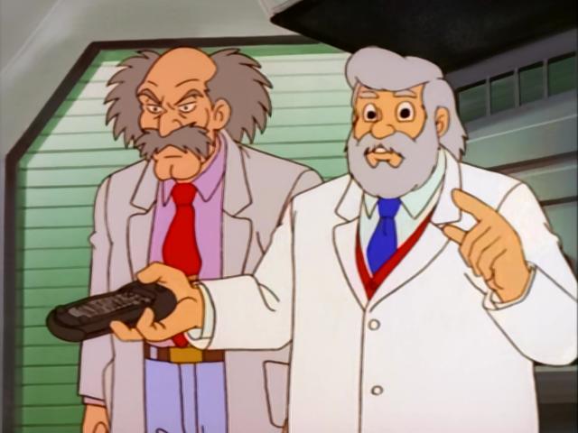

  18. Oh and a little white balance adjustment may be called for:
    ColorYUV(off_u=3, off_v=-3)

  19. Originally Posted by jagabo View Post

    After:
    Mpeg2Source("VTS_02_1.demuxed.d2v", CPU=6)
    AssumeTFF()
    checkmate()
    QTGMC(preset="fast")
    SRestore()
    deen()
    ChromaShift(C=2)
    MergeChroma(awarpsharp2(depth=32))
    crop( 10, 4, -10, -4)
    LanczosResize(640,480) # Lanczos (Sharp)
    I get:

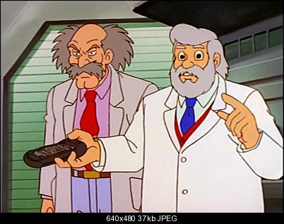

    I kinda finished mine before I saw your post on here. I like your result as usual, Id only add one or two things.
    This is what I got from my finished script before I saw your reply. It looks like it has less noise and a bit sharper.

    No I didnt use chroma shift, I never used it before and didnt know what it was. I never heard of it untill I saw that reply and that was after I was done already. Ill have to play with chroma shift a bit.
  22. Yeah, see the guy on the left, how his hair color seems to extend to the left of where it's supposed to be? The colors (chroma) on this thing seem to have shifted to the left a little bit (2 pixels, apparently). You can see on jagabo's before and after pictures how it gets fixed after using the Chromashift filter. This sort of thing is fairly common with anime and even on poorly made live action DVDs (often sourced from VHS tapes).
