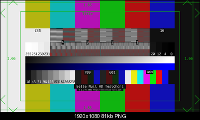

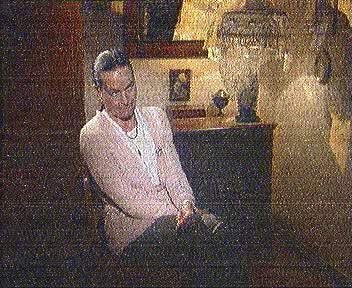

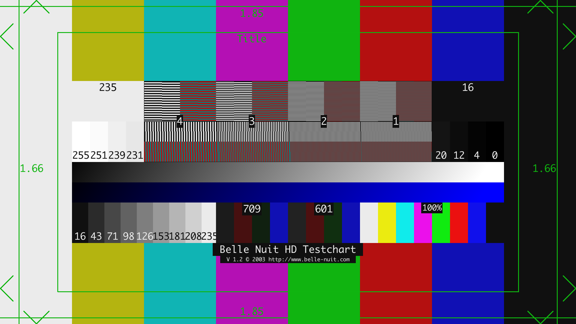

    For compressed images there is no simple relationship except larger frames tend to make larger files. But the amount of detail and noise in the image, and the settings used in the codec, can make a big difference. For example here are pair of PNG images:
    Both are lossless PNG images. The first is 352x288 pixels and the file size is 287 KB. The second is 1920x1080 but the PNG file is only 80 KB.

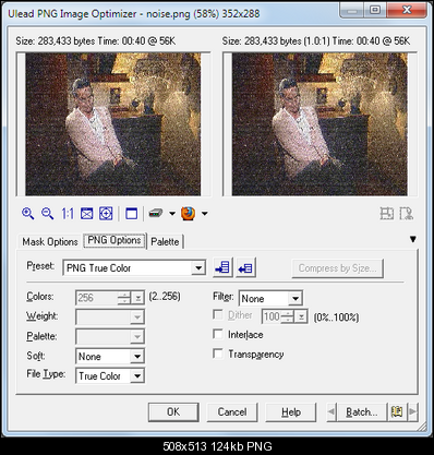

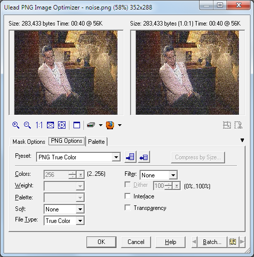

  7. Ulead PhotoImpact -- version 6, over 10 years old! After selecting File -> Save As -> PNG:

    Jagabo, what program do you use to resize/edit the image or video that can tell you the file size before you save it, by the way?
    Photoshop's Save for Web option shows you the file size when you slecet a compression level. Find the right the compromise between quality and size, then save. Save For Web does jpg, gif and png.
