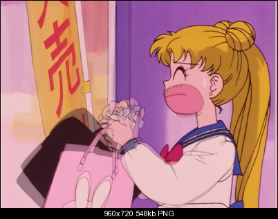

  9. Click image for larger version
    I can spot some interlacing here and some other frames as well.
  10. I haven't looked at any of your videos closely yet ; is that screenshot from a video you posted? If so , which one ?
    If you haven't posted it, then post an unprocessed sample that contains the problem
    Also post your current avs script
  11. Yes, It is a screnshot from the episode, not from the frames above
  12. Well, then post a sample that has a problem, not a sample that doesn't have the problem
  13. I need go by today, sorry cuting it in the middle.
    Thanks for you helps I'll came here by (local) tomorrow.
  14. I think the very first one (in compressed video) has a interlace issue in the Usagi's (blonde haired'girl) Mouth.

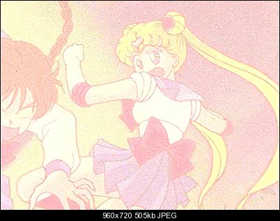

  18. Click image for larger version
ID:	8303Click image for larger version
    I don't know if I'am alowed to bump it sorry if not.
    LoadPlugin("C:\Arquivos de programas\AviSynth 2.5\Plugins\DGDecode.dll")
    MPEG2Source("C:\Documents and Settings\User\Desktop\Episódio 1.d2v", cpu=6)
    LoadPlugin("C:\Arquivos de programas\AviSynth 2.5\Plugins\TIVTC.dll")
    LoadPlugin("C:\Arquivos de programas\AviSynth 2.5\Plugins\Deen.dll")
    LoadPlugin("C:\Arquivos de programas\AviSynth 2.5\Plugins\nnedi3.dll")
    LoadPlugin("C:\Arquivos de programas\AviSynth 2.5\Plugins\aWarpSharp_2\aWarpSharp.dll")
    TFM()
    Tweak(-1.7,1.28,-15,1.03)
    Levels(26,1.064,224,0,250)
    ColorYUV(gain_y=5.5, off_y=4.5, gamma_y=5.5, cont_y=7, gain_u=-7, off_u=-3, gamma_u=2, cont_u=-4, gain_v=-3,off_v=-3, gamma_v=-8, cont_v=8)
    Deen(mode="a3d", rad=2, thrY=9, thrUV=10, min=0.5, scd=10)
    nnedi3_rpow2(rfactor=2,cshift="spline64resize", fwidth=960, fheight=720)
    aWarpSharp2(75,18,1,14,4)
    Sharpen(0.6)
    In some instances it looks noised like in the attachment, I also added some color "corrections" cause the fansub wants it.
  19. If you feel some frames are still "noisy", apply a stronger filter to those sections. This applies for any filter - You don't have to use the same filters for the entire episode.
    e.g use trim() to divide up into segments
  20. Besides that The script could be improved?
    Where I can get a nice encoding guide?
