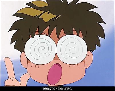

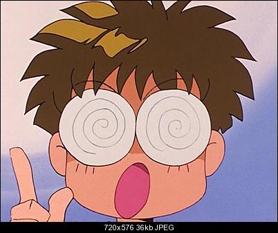

  4. Before:
    After:
    Note the JPG compression added a bit of mosquito noise. Click on the images to see full size versions.
    You might try adding Stab() to remove some of the film bounce.

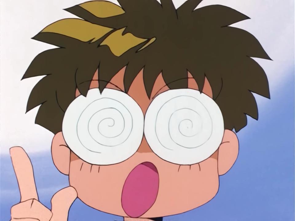

  6. Member dragonkeeper's Avatar
    Jul 2003
    Good work and welcome to the world of Avisynth.
    But the image looks a bit soft to me. It's most noticeable in the spirals on his glassess and the tip of the extended finger. Over all it seems the edges have become a bit thinner. From the drawing style this appears to be an older series and will no doubt even the DVD has a considerable amount of niose.
    1. I see in the ColorYUV filter you did not specify "opt=coring" be aware this can lead to invalid TV-ranges, (not a problem if you only plan to view these on your PC). I personally prefer Tweak over ColorYUV.
    2. Verify the video is interlaced. Most DVD were progressive, if this was ripped from a DVD you most likely do not need the Nnedi3 filter.
    3. Deen, for all intended purposes is a combination of multiple smothers/de-noisers, you then proceeded to add additional smothers to your script.
