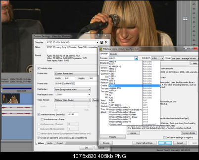

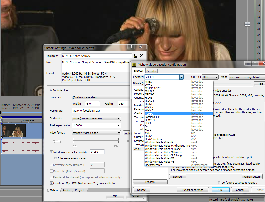

    In Vegas Pro Help search "proxy" and see their writeup. They recommend DV or SONY YUV frame based codecs for proxy editing.
    From the Video for Windows, Sony YUV custom menu, you can set frame size and also replace codecs including MJPEG under ffdshow. You can then experiment with frame size and bit rates.
    In this 1280x720 59.94 source example, I selected a quarter size proxy with RGB MJPEG compression. In this case the frame rate would come out 59.94. For frame accurate edits this could be reduced to 29.97 for the proxy.

  8. Member edDV's Avatar
    Mar 2004
    Northern California, USA
    click on picture to enlarge
    Frame based codecs will allow precise edit point specification. xvid or h.264 will result in a sticky timeline depending on the speed of the user's computer. Search to frame will be more difficult with GOP based codecs. Experiment with similar equipment.

  29. Member edDV's Avatar
    Mar 2004
    Originally Posted by Taapo View Post
    I just tried Sony Yuv. I can only set the video image size, not the bitrate. After reading up on the format, it's meant to be an "intermediate" format (as it creates files double in size from my cineform neoscene files), not as a proxy format. So, unfortunately this is no solution for my situation (small uploads). Is there a frame-based codec that allows me to go down to a 250Kbps bitrate and compresses as good or near the size of Xvid? I'm asking a lot, I know - but you never know if there is a codec I don't know of ...
    I was showing the menu path in Vegas to get to first an uncompressed baseline (Sony YUV as recommended in proxy help*), then to Video for Windows codecs for further compression (intraframe only recommended).
    From there you experiment with frame size, codecs and bitrate testing on user level equipment.
    It is important to test the full process including proxy edit on user level machine, then EDL load with original clips to online machine to see if the edit points match.
