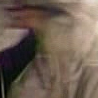

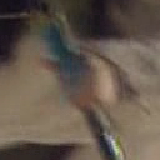

  10. No blocking artifacts? They're all over the place. Whenever there's movement. Worse though, perhaps, is that a PAL2NTSC field-blended source was simply deinterlaced leading to the extreme blurriness. If the encoder knew anything about what he was doing, he'd have made it progressive by unblending it back to the source framerate, most likely 25fps. But without the 'true' source, I can't be positive about that. In any event, I wouldn't hold up that episode as a good example of how to encode.

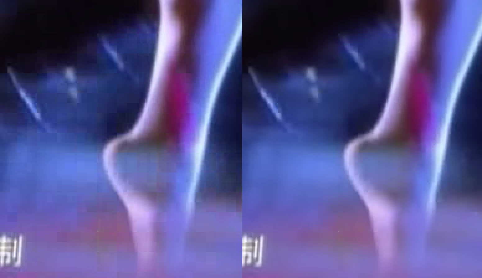

  11. Maybe the difference is what decoder is being used and whether it's set to deblock or not. For example you can have a Divx video (fourcc = DX50) and an Xvid video (fourcc = XVID) with similar amount of macroblocking. But if one is decoded by the Divx codec and the other by the Xvid codec, and one of those decoders is set to deblock and the other not, the two will look different on playback. A portion of frame 2331, decoded with Xvid, deblocking off and deblocking on, 4x nearest neighbor enlargment:

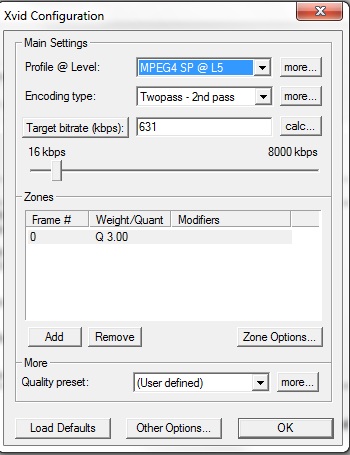

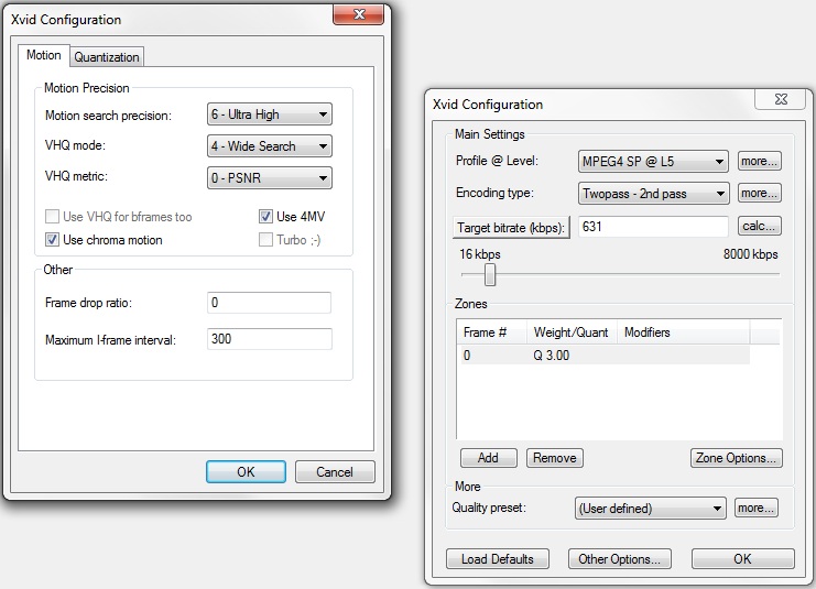

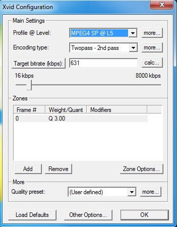

    xvid is what I used for my encoding and this is what I set for the xvid before I encoded the video, but it still has a lot of blocks on the fished-product.
    Just because you use Xvid to encode the video doesn't mean it's also being used to decode the video. Other codecs can decode Xvid. Divx and ffdshow for example. And many players have built in Xvid decoders. VLC, MPCHC, KMPlayer, etc.

  22. Originally Posted by kenryuakuma View Post
    The original DVD does not have blocks...
    Yes it does. 4x nearest neighbor zoom from frame 1547 of the sample:
    With DgMpgDec's deblocking option:
    But there are blocks everywhere when there is a movment after encoding using xvid. I will try constant Quant 3 and see if there is any block after encoding.
    Deblock the the source first.

    BTW, how can I set Constant Quant 3? Below is what manono said. And this is what I used
    "Like I said before, if you don't want blocks, encode using Constant Quant 3. If the blocks are in the source, remove then using Deblock_QED or similar, or add in deblocking when setting up the DGDecode line in the AviSynth script. Doing it that way, though, softens everything and not just the areas with blocks."
    Also, here is what I am doing...Deblock the source (Original source) with avisynth script, then encoded with two passes by using Xvid code...As you can see below, I want my video to be 455MB for each episode. But the outcome, after encoding, still contains blocks when there is movement.
    Click on the button "Target Bitrate", it will change to "Target Quantizer".
  25. 630 kbps probably just isn't enough bitrate for your video. But there are a few other things to check:
    1) You might want to press the "Load Defaults" button to get everything in a known state -- in case some of the settings are way out of whack.
    2) Press the "more" button on the Quality Presets line. Select the Quantization tab. Make sure the min quantizers are set to 1 or 2.
    3) Enable Adaptive Quantization.
    Target Quantizer 3 will still have a little macroblocking. 2 will pretty much eliminate it. You will have no control over file size when using Target Quantizer mode.

  26. Member
    May 2009
    I do not see the Target Quantizer 3 or something like this.
    so jagabo...what you mean is that I have to sacrifice either the file size for quality to eliminate the blocks or quality to get the satisfied file size with blocks?
    I am striving for is filesize with decent quality without blocks...It is ok if the video is a bit blurry and all I want is to get rid of the blocks.
    Another question is with H.264 for the encoding, I don't see any blocks even if I set the known file size about 300MB or 350MB but see blocks whenever there is movement with xvid and the file size is already 400MB or more? Because of different algorithm for compression?
    kenryuakuma always need your help
  27. Originally Posted by kenryuakuma View Post
    Press the "Target Bitrate (kbps)" button. It will change to Target Quantizer. The value next to it is the quantizer value.
    Yes.
    If you really need a specific file size you have to use bitrate based encoding. If you are getting too many macroblocks you can reduce the frame size. The smaller the frame the less bitrate it will require. But you're trading off resolution to get fewer macroblocks. You can reduce the frame rate too (fewer frame per second requires less bitrate too) but the video will get jerky. Also, using strong noise reduction filters before compression will reduce the bitrate requirement.
    h.264 applies a deblocking filter during decompression. And it has other features which allow it to compress better than Xvid.
    Xvid has a similar deblocking feature (see the Decoder options) but that will only help on the computer. Hardware players usually don't have the deblocking option.
    [/QUOTE]
  28. Member
    May 2009
    I don't think the Target Quantizer exists in the encoder of xvid...It only has target size and target bitrate if I press the button to switch between the two.
    These are the pics.
  29. Originally Posted by kenryuakuma View Post
    Change it from 2pass to 1pass
