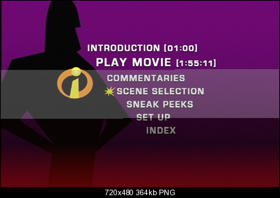

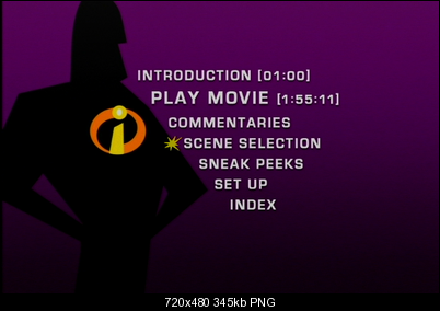

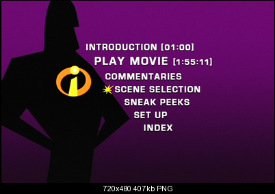

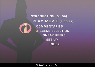

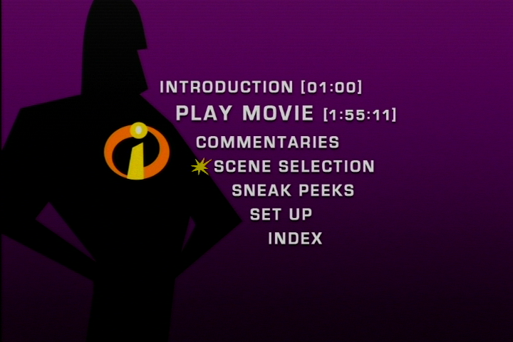

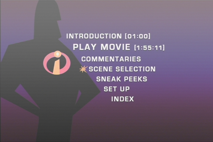

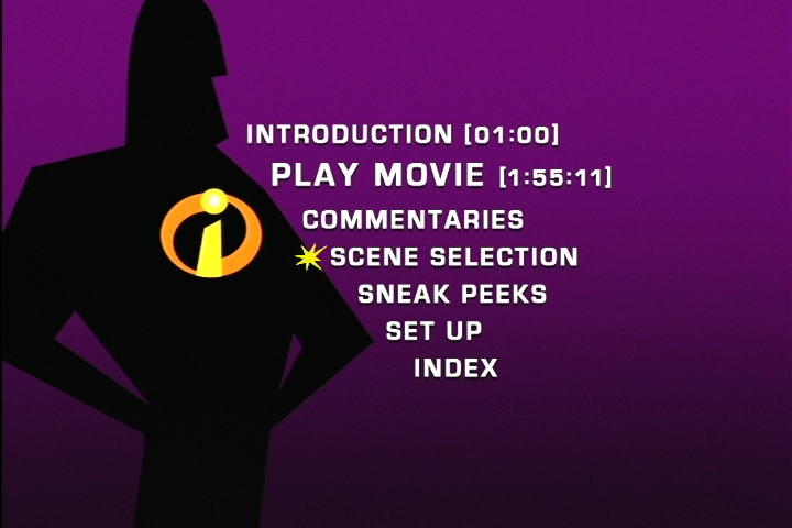

    I just purchased a Hauppauge WinTV HVR-1250 yesterday and I believe I have found a bug when capturing raw analog video from the S-Video or Composite input. When using VirtualDub, I noticed that some of my captures were a little bit darker than the others and decided to investigate. It turns out that shortly after capturing begins a "glitch" would occur that causes the picture to dim and stay dimmed. Now, this doesn't happen all the time and appears to be random. Here are 4 sequential frames of the glitch occurring (the first is a "good" frame):
ID:	8092Click image for larger version
ID:	8090Click image for larger version
ID:	8093Click image for larger version
    I've uploaded a .zip containing two raw .avi captures (encoded with HuffYUV) to MediaFire here: http://www.mediafire.com/?pnjwwdavxxxk4aw . "bad.avi" has the glitch, "good.avi" does not. They were taken from the start of two separate captures and no frames were cut from the beginning.

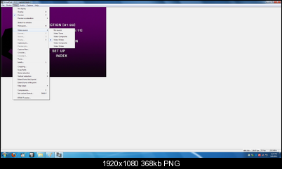

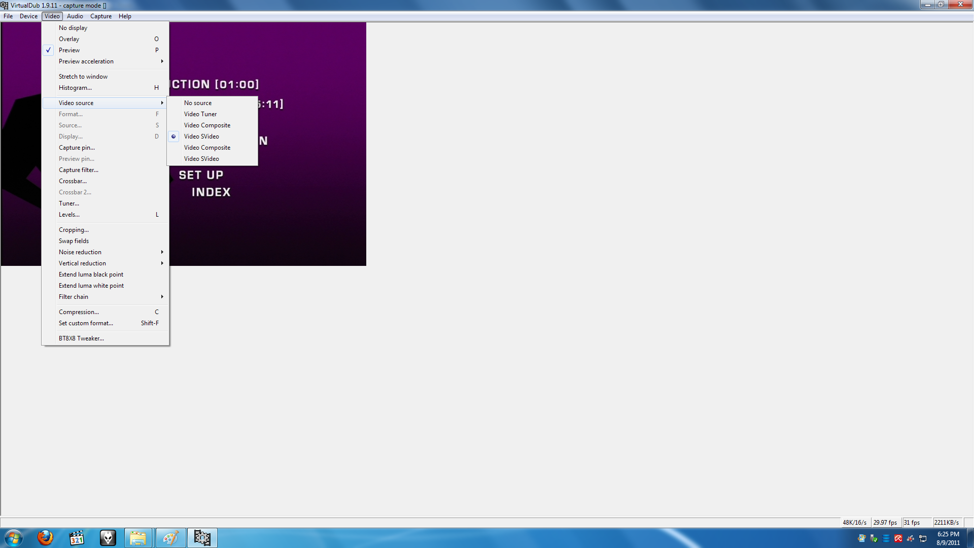

    I also noticed that under the "Video sources" menu in VirtualDub there are 2 S-Video inputs and 2 Composite inputs:

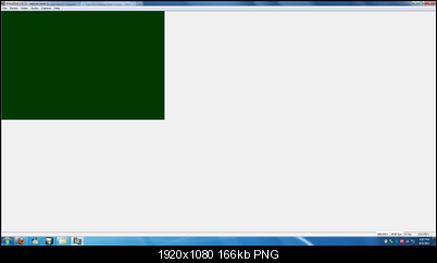

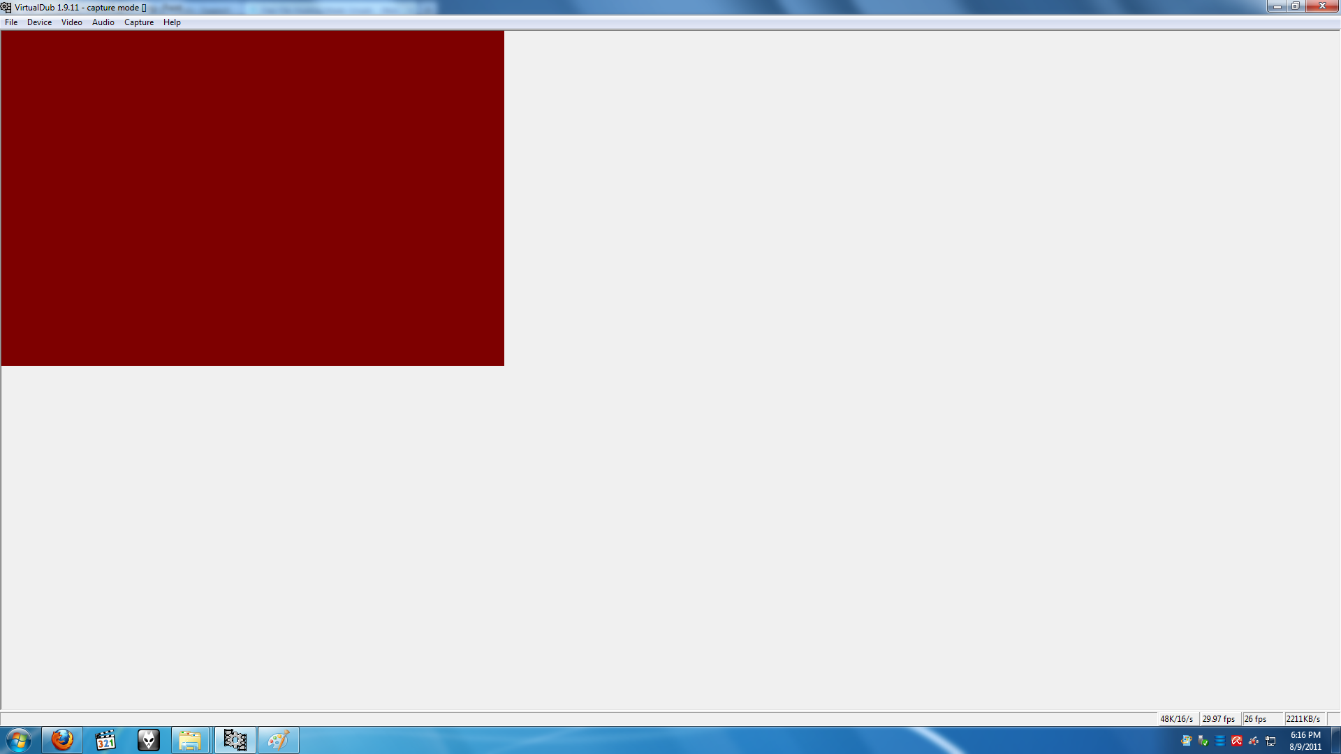

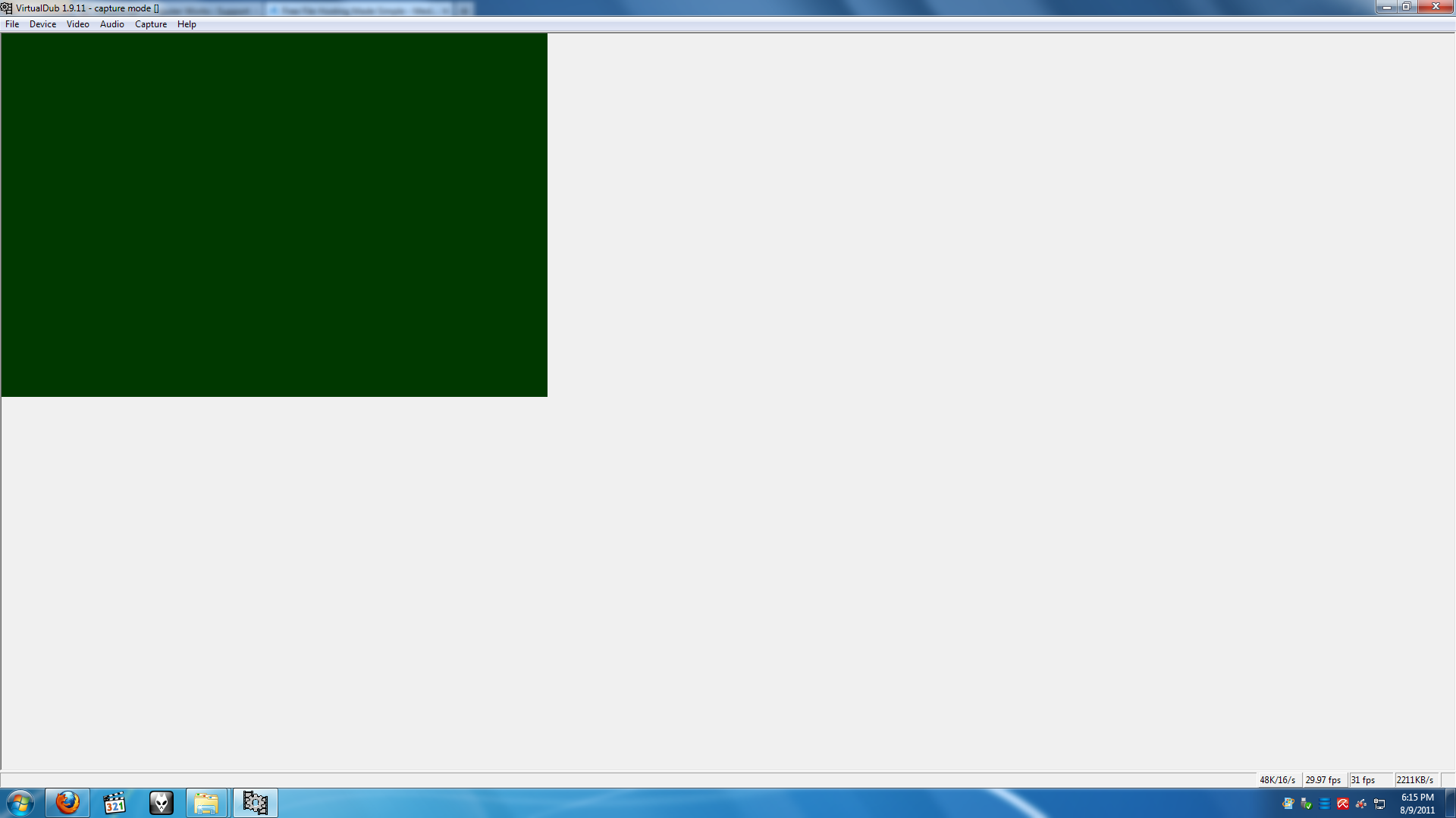

    The first S-Video option displays the actual video stream, while the second seems to display either a completely green or completely red screen.

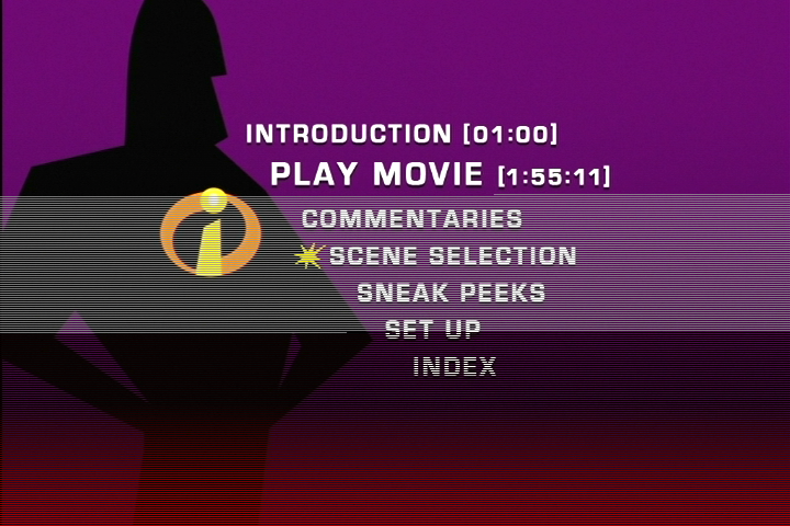

    I can also get the glitch to occur (randomly) while I'm not capturing (i.e. when I'm in "Overlay" or "Preview" mode). If I go to the "Device" menu, select another device, then select the Hauppauge card, sometimes the glitch occurs. At this point it appears that if the glitch DID NOT occur then switching to the second S-Video option displays a green screen, and if the glitch DID occur then switching displays a red screen:
ID:	8097Click image for larger version
    Notice that in the second of the "glitch" screenshots, the bottom portion of the screen has red fields. What I think is happening is that shortly after the card is initialized some error occurs that causes the second S-Video source to turn red, and also causes the first S-Video source to "glitch" and get dim.

    I've come across a new development while playing with my JVC HR-S9600U: in VirtualDub while in "preview" or "overlay" mode, if you switch to the "second" S-Video source and it shows a green screen, and if you then switch to the "first" S-Video source, press "Menu" on the JVC remote to show the OSD menu, and then switch back to the "second" S-Video source, it will show a red screen.
    Intrigued, I did a test capture in which I paused a VHS tape and then entered and exited the JVC OSD menu. I then compared the frames before and after entering & exiting the OSD menu, and they were identical in color and brightness. I also confirmed that the beginning of the capture didn't have the glitch, so the picture wasn't dim to begin with. What this leads me to believe is that the "glitch" (and subsequent dimness) I'm getting isn't related to the red screen at all, and that the red screen is an indicator for something else.
