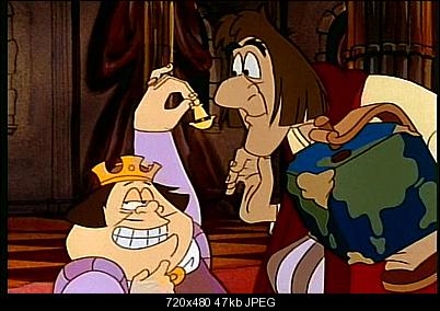

  1. Im not sure what this problem is called but, I believe it has to do with the deinterlacing. I usually trust MeGui to properly analyze and tell me what kind of deinterlacing to do and its usually always very good and right at it. For some reason this time Im seeing something over my video though and I dont know how to get rid of it. this is what Im seeing.
    You will notice they look kind of like blinds. I have changed the deinterlacing settings and and a couple of them get rid of the lines but at a cost. That cost is, I can see double imaging instead of blinds its 2 full sets of images at the same time blended over each other.
    Does anyone know how I can get rid of this??

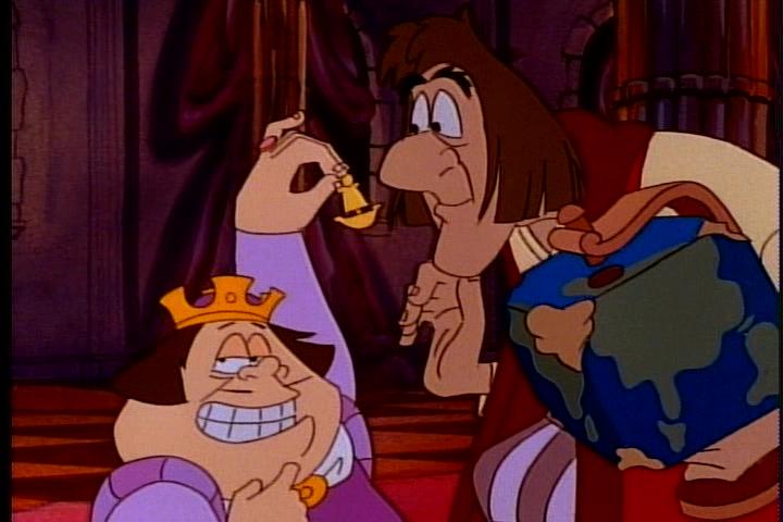

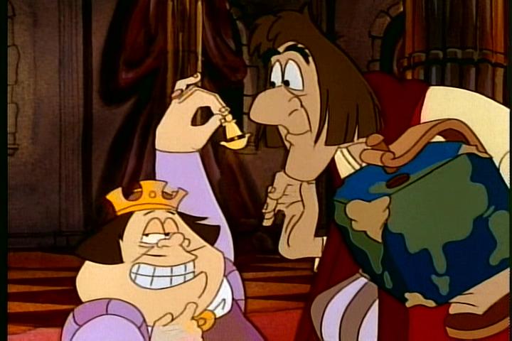

  12. Here's the result of the aforementioned QTGMC() script. It's much better -- fewer blends, smoother motion.
    Also try a little color correction. The exact correction varies by shot but this is a rough starting point:
    ColorYUV(gain_y=100, off_y=-6)
    ColorYUV(off_u=-11, off_v=-5)
    Before:
    After:
