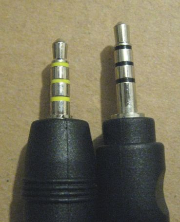

  3. You may have a difficult time locating the right AV cable. I own a portable Dynex player and an LG one. The AV cable tip size isn't the same.
    In the attached photo, the one on the left is for the Dynex, the other is for the LG. Most cables found on eBay are like the Dynex one. You probably have the Dynex one, so you need to try the longer LG tip. LG supplied the cable with the DP885, DP382, and DP351-N for example. The cable may not be cheap though. I couldn't find it on the Partstore.com website. You can try looking for a defective LG portable player and hope it comes with the AV cable on eBay.
    That or cut the tip off the Dynex cable and solder on a new tip. The Dynex tip is about 19/32" long, the LG is about 11/16" (22/32"). No guarantee it'll work and you risk damaging the player.
    There are clones of your player: Ultech UT3207 and GPX PDL705. It could be under other brand names as well. Good luck in your search.

  4. Thank you both greatly for the quick replies!! It is greatly appreciated!! em-t-wallitt I believe your correct. I most definitely have Dynex one and always noticed that it didn't seem to go in all the way, like it was to short. I will definitely try and search for the longer LG one instead. Thanks again!!

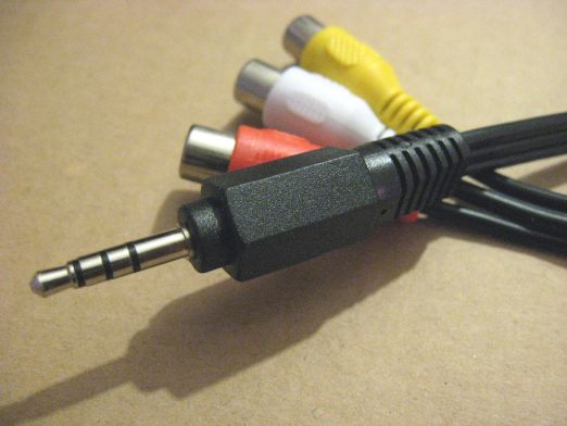

    Also, FYI, the Sylvania SDVD9000 player comes with the longer tip AV cable. This may apply to other models in their product line. You can see the other end of Sylvania cable has input jacks, so you need another AV cable from the dollar store to hook up the player to a TV. My Dynex cable is similar to this one.
