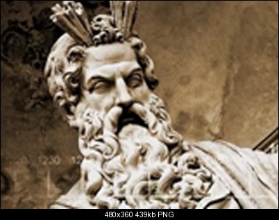

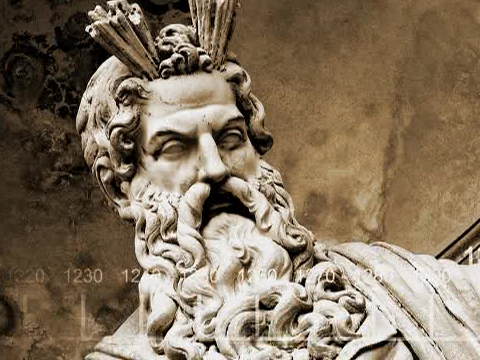

  14. You're not going to change this:
    into this (the same change in scale you are contemplating):
    you're going to get something like this instead:
    It's a waste of time. You're media player or TV can do just as well.
