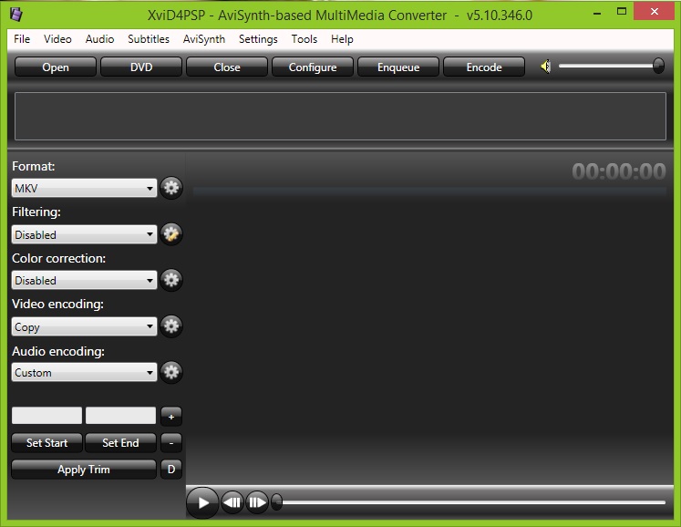

    I have Windows 8.1 x64 and unless we're talking about different programs my copy installed here:
    C:\Program Files (x86)\XviD4PSP 5\apps
    Maybe you're talking about the installation exe:
    XviD4PSP_5.10.346.0_(2015-02-12)_rc34.1.exe
    DTS-HRA/LBR decoders don't just drop out of the sky and as far as I'm aware the closest thing to a "free" version is the Arcsoft dll. Sure enough, once I removed that dll from my SysWow folder the program was only capable of decoding the core.
    If there IS some wondrous app that decodes DTS-HD without the Arcsoft dll while remuxing from and to any kind of file imaginable I'd really like to know about it.Click image for larger version

  18. Member rforgaard's Avatar
    Feb 2015
    Hollis, NH
    Hi, ndjamena. Again, very useful info. I also have Windows 8.1 x64. It appears we are running different versions of XviD4PSP. I am running the 7.0.108 Beta version rather than the 5.10.346 released version. (I just now went to the VideoHelp XviD4PSP page again, and discovered that the newest Beta release is now numbered 7.0.109 - that must have been updated within the past couple of days.) I have attached a screen shot of what this Beta version looks like.
    Anyway, with the Beta version, it doesn't actually install as a traditional program. It seems to just run as a stand-alone .EXE that doesn't have a separate install step.
    Still, though, based on your notes on this thread, I would guess that perhaps under the covers the Beta version still runs the other tools (ffmpeg, aften, MKVmerge), perhaps by embedding those tools somehow into the .EXE file. And that was an interesting note in your message that DTS-HRA/LBR encoders are rare beasts and the closest thing to "freeware" would be the Arcsoft DLL, so most likely XviD4PSP is using that Arcsoft DLL as well.
    Just to be clear, I'm not trying to push one shareware/freeware tool over another. I was just posting on this thread because I originally came to this thread (and one other thread here) when I was trying to solve this DTS-HD video conversion problem. This thread helped me to succeed, so I was just trying to report back on what worked for me in case it is useful to others.
