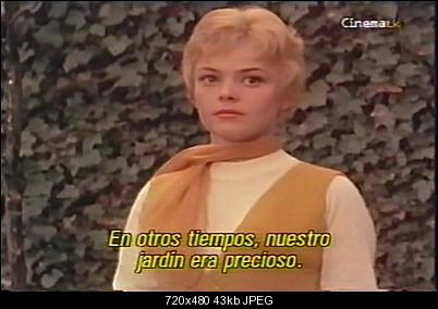

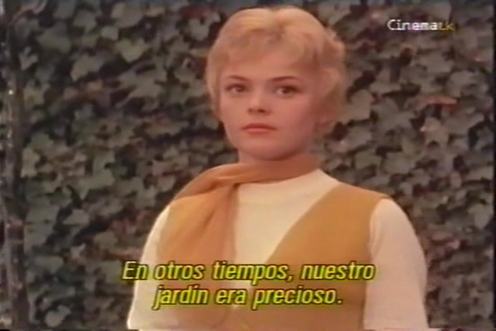

    Original frame

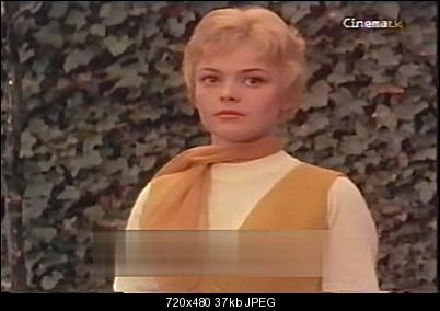

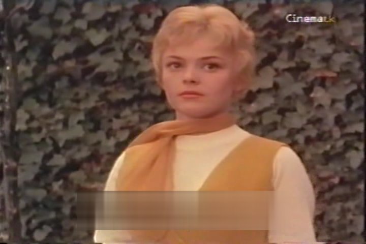

    Logoaway (XY mode)
    RegionRemove

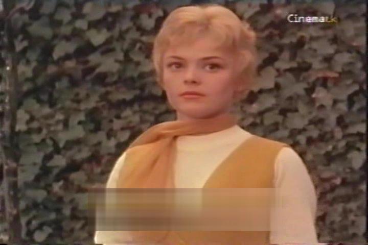

    BilinearResize
    The script I used was:
    aux1 = Trim(270,271)
    aux2=Crop(aux1,150,374,-150,80).BilinearResize(30,6).BilinearResize(430,80)
    v1=Overlay(aux1,aux2,150,374)
    v1
    ConvertToRGB()
    As you see, Logoaway and RegionRemove had made a better job than my crop-resize script.
    Is there another way to write the script to get better results?
    Also to treat the borders. Borders at my script are too hard and visible...
    Thank you.

  9. I have some results to show.

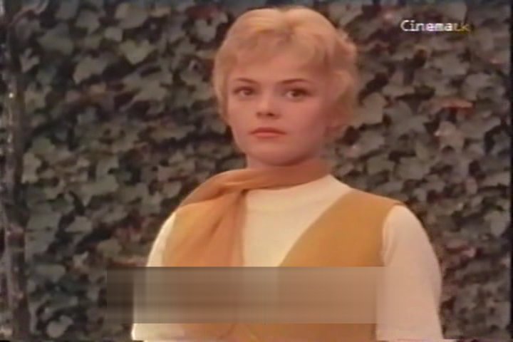

    Applying XLogo and AlanHK guide:
    Small clip using XLogo:
    http://www.4shared.com/video/78QxABYR/xlogo.html
    Using RegionRemove:
    http://www.4shared.com/video/QaBaDRSS/RegionRemove.html
    Using Logoaway-XY
    http://www.4shared.com/video/A6lIQh1V/Logoaway-XY.html
    I think the problem to handle a range of frames is over. Thank you Gavino and AlanHK. clap, clap.
    Now, I ask if I applyed XLogo correctly. As we can see, the other VD filters blur the area better than XLogo. Also, the performance (less time) to get the final AVI of RegionRemove and Logoaway is better than XLogo.
    The blurred area blinks to much using XLogo script.

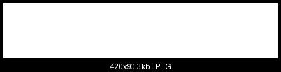

    The mask I used is this one:
    I put 4 pixels of clear black, as described at the guide.

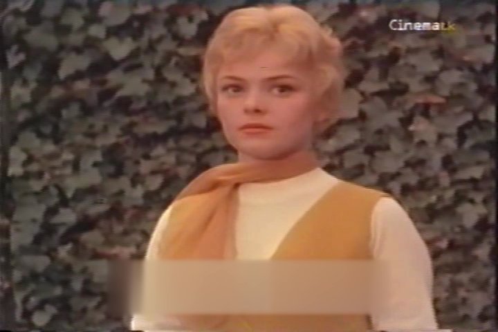

  12. BilinearResize() didn't like 2 pixel high or wide images so I used 2 lines of pixels top and bottom, left and right. And because of that it was necessary to blur the 4 pixel thick boxes:
    ImageSource("sub.jpg")
    box1=StackVertical(Crop(172,368,380,2),Crop(172,45 2,380,2)).Blur(1.0).BilinearResize(380,84)
    box2=StackHorizontal(Crop(172,368,2,84),Crop(552,3 68,2,84)).Blur(1.0).BilinearResize(380,84)
    Overlay(Merge(box1,box2),172,368)
    Result:
    Warning: the forum software adds spaces here and there.
    Personally, I'd just leave the subtitles there. The ugly box of garbled pixels is more distracting.

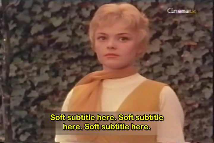

  14. Hi guys!
    It's time to say thanks for all of you!
    With our pleasant discussion I could learn new things. First, how to call a VD plugin from as Avisynth script. Also, how to use a list of frames with ReplaceFrameSimple. How to use another logo remover, XLogo. And now, how to apply some Avisynth internal functions to get the same effect of the VD filters.
    Great. Not just for me, but anybody else who wants the same target.
    Jagabo,

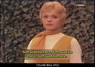

    I agree. That ugly box of garbled pixels is crap. But I'll overlay new subs there, like this:
    The script will affect just when hard subs appears.
    Gavino, AlanHK and Jagabo, you all helped a lot. Thx.
    Thank you.
  15. Member AlanHK's Avatar
    Apr 2006
    Hong Kong
    Well, in that case there is a much easier way.
    Make your new subtitles with a solid, or semi-transparent, background. No need to blur the original subs at all.
    I've done this several times, when ripping a Japanese video with burnt in Chinese subs and I want to add English.
    You need to make bitmap subs, such as SUP or SUB/IDX.
    Or make a DVD, add your subs as normal, then open the VOB files using DVDSubedit and adjust the background colour of the subs (normally transparent) to taste. If the original subs are bright and distracting, just dial it up to black.
    Usually the new subs will be synchronised with the old ones, so no problems with filtering ranges.

    Like I said, edit the colours in DVDSubedit after you've made it.
    Obviously, add a line to the soft sub, divide the line or add a blank. And/or increase the font size.
    SubtitleCreator has a lot of options affecting the appearance and size of the subs.
    I don't worry if there is a bit of the original sub still visible, as long as the new sub is clear.
    I followed your advices, AlanHK. Good tips.
    I'd consider just blacking out the entire bottom of the frame for the whole video and having the new subs there. Although that's butchering the picture it may be less annoying than black boxes with subs popping up all the time. Like cutting off a gangrenous leg...
    Jagabo, I agree about the 'blinking bars' with subs. To avoid that, I adjusted my code to make a continuous range of adjacent frames where the difference was less than 20, 30, 50... (whatever, controlled by user) frames. It often occurs during dialogues. So, if there are few frames between two bars, I adjust the frames to give just only one bar along the whole dialogue, or bunch of successive speeches. It also avoids a bit of the original subs remains visible, because the continuous bar is covering all bellow of it. I may also add some frames before and after the bar to make sure it'll cover the original subs.
    Also, to get synchronized soft subs with the hard ones, I use the TXT mask file generated from the MSU SubtitleRemover to create an empty SRT file, just with time-codes, where I fill with text later, using SubtitleWorkshop, just in one step.
    But indeed, the blurred bars are far ugly. AlanHK and myself know what we must to do when some movie drops in hands and there are no other source of it. We have to close eyes and make the dirty work.
    Thank you.
