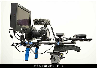

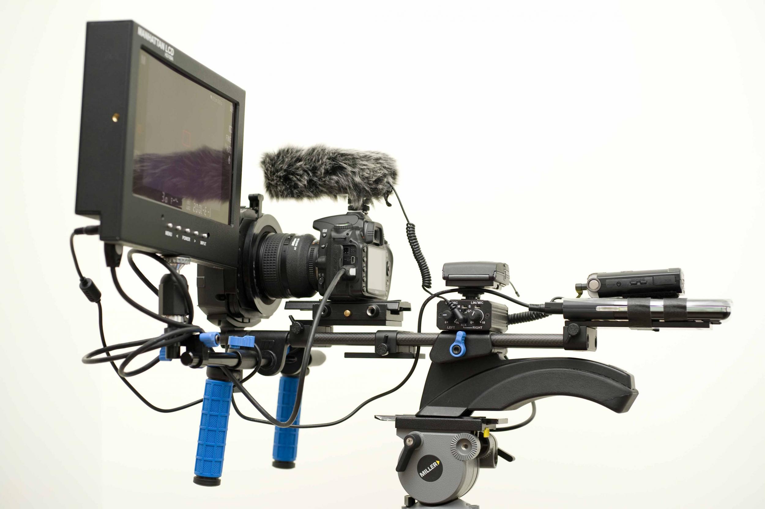

    A DSLR is not a pro camcorder but can approximate one with external accessories. A pro camcorder has all this built in. The DSLR advantage is all about adapting low price interchangeable lenses. DSLR's are most appropriate for B roll (no audio).
