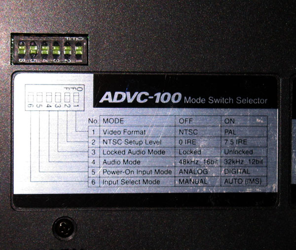

  7. Member edDV's Avatar
    Mar 2004
    Northern California, USA
    ADVC100 switch settings for PAL
    1 on
    2 off
    3 off
    4 off
    5 off
    6 off
    First connect input to a stable video source. Then feed output to a TV monitor.
    Press silver button on top until the source video shows on the monitor.
    Connect IEEE-1394 cable to computer.

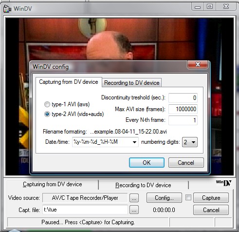

    If you can't get Scenalyzer to see it, try WinDV. WinDV is a simple program that sits over DirectShow.
    The ADVC should show in the input selector as "AV/C Tape Recorder/Player".
    If WinDV doesn't show the ADVC, something is wrong with your DirectX install or the motherboard driver for the IEEE-1394 port.

    Hi..Many thanks..I had the DIP settings correct but .I have had a day of frustration with finally a hint of success..I changed the firewire card to another that arrived in the post today but I got a code 10 ,then switched slots and lost my soundcard while I gained the firewire card ...anyway finally I got both cards installed and working properly ..and cabled up_ powered up and switched on my PC and immediately Windows Movie Maker was telling me it was seeing a capture device ...I then opened ScenalyzerLive and there was my VHS tape on screen...But unfortunately I had a few audio glitches and finally ScenalyzerLive gave up the ghost ..So I closed it and restarted but I have another error ... I know the ADVC unit is working but I fear something is still not 100% ..Tomorrow I will cable the Datavideo 3000 into the loop and hopefully do some capturing...I will also try WinDV as the ScenalyzerLive that I have seems to be flakey...The videos are all old music bootlegs so there is no copywrite protection on them ...I just want to try and get the best quality capture I can and write to disk for my fellow musicians so there will be little editing etc...
    I really appreciate the help I have been given...Cheers HK
