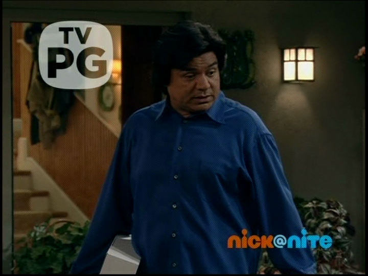

    I've captured some video from a cable box using a dvd recorder, the problem is that the cable box output includes black bars. I want to crop and re-size the video. I'm familiar with the avisynth and I've used this script before. The script was based on what AVStoDVD uses for cropping.
    LoadPlugin("C:\Program Files\AVStoDVD\Lib\LeakKernelDeint.dll")
    LoadPlugin("C:\downloads\dgmpgdec158\DGDecode.dll")
    MPEG2Source("special 1.d2v")
    ConvertToYV12(interlaced=true)
    LeakKernelBob(1,7,false,false)
    Crop(84,58,-86,-62)
    Spline64Resize(720,480)
    SeparateFields().SelectEvery(4,1,2).Weave()

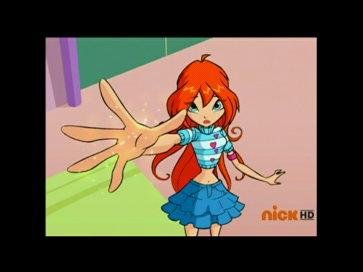

    My question is if this method is the generally recommended one or if there is a better way to do this? Attached is a frame grab made using dgindex and is unaltered except for jpeg compression.

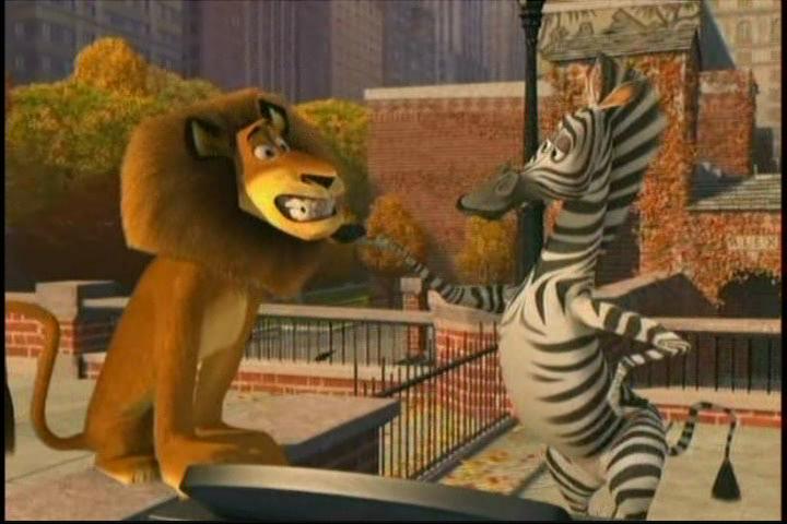

    You captured incorrectly. SD cable outputs digitally from the set top box as 524x480i over IEEE-1394. Just rescale horizontally and interlace is preserved. You can h rescale to 704x480i for true 4:3, or to 720x480i (slightly wide stretched).
    Depending on the channel selected, most cable SD broadcast channels output analog 4:3 480i. If you capture 720x480i, expect eight pixel sidebars with the real video contained in the center 704x480. It should look like this and interlace is intact.
    Note the 8 pixel blanking left-right.

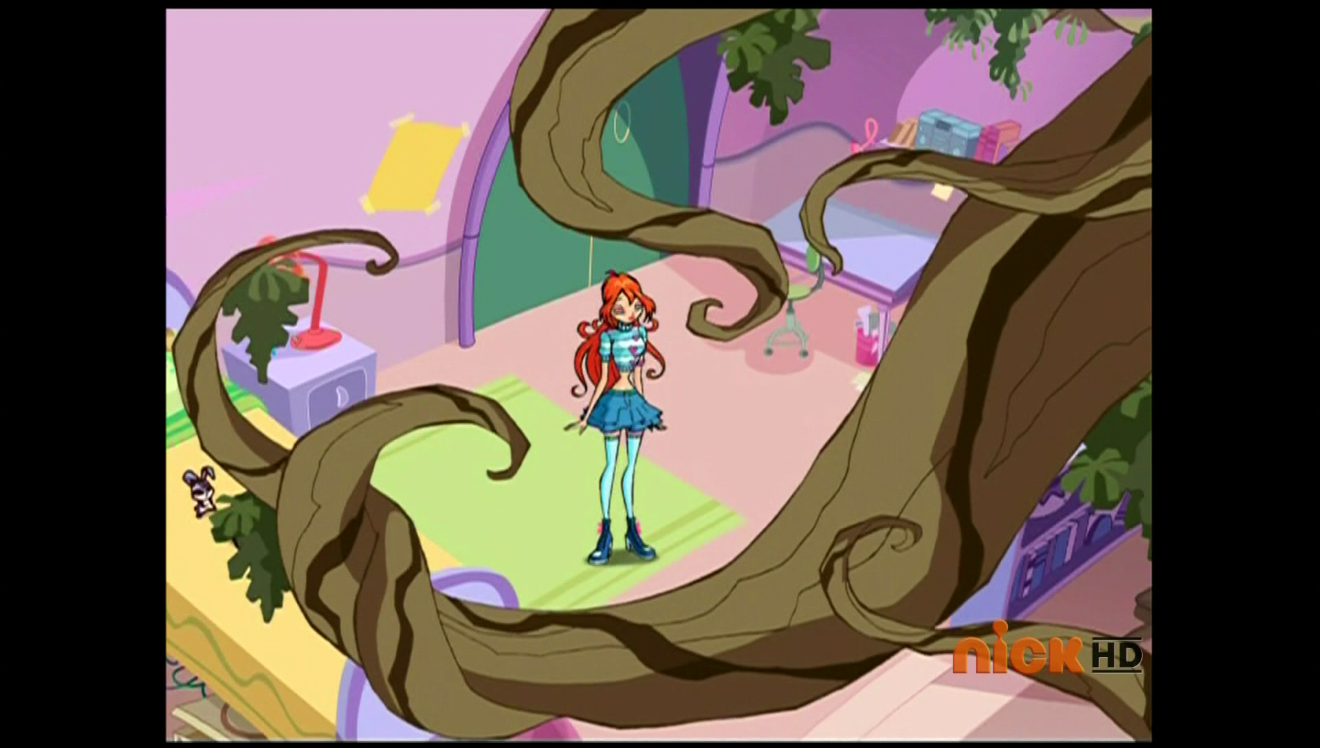

    Now I notice you are capping a 4:3 program from Nick HD... ... OK found Nick HD. Never kwew it existed.

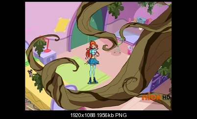

    The show is 4:3 so HD cap shows side pillars.

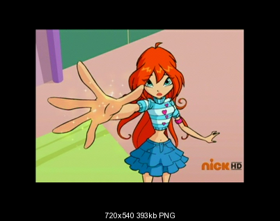

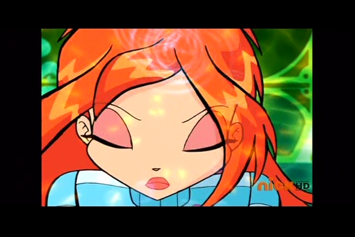

    If I cap the HD channel off SD S-video the 16:9 outer frame is letterboxed
    (pillared inside letterbox .. hence 4 black edges.).

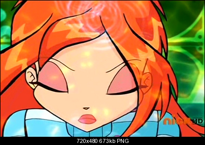

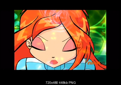

    before:
    after:
