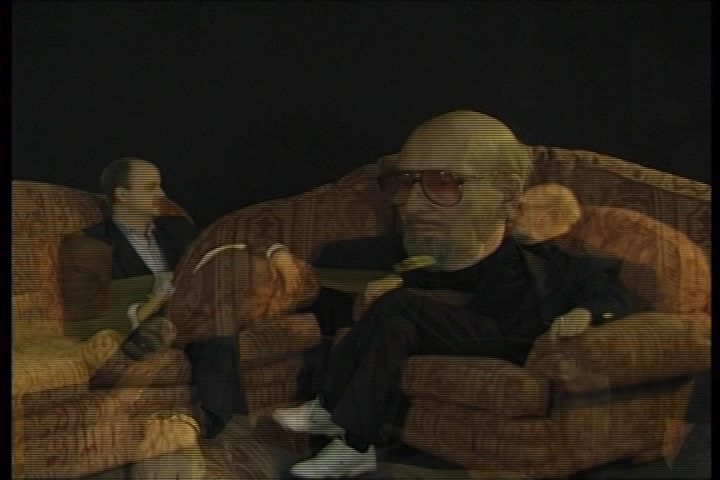

    I placed the resizing line "Spline36Resize(720,480)"at the bottom, right after Weave. Because this is interlaced, should I have placed it somewhere else?
  8. It looks to me like you resized after interlacing. You should resize while the video is progressive. I'd do it right after Yadif().
